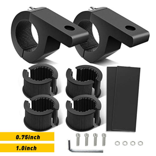

chin_k wrote: ↑April 4th, 2022, 9:23 pm
I have been considering using wider panels as well and have been looking for clamp style rail mounts. The bars on my roof measure fairly close to 7/8" in diameter. I have attached a photo of some clamp mounts I found on ebay that look like they may be adaptable to this situation. Additionally I am curious as to what panels you are using. I've seen pictures of the 20 inch/100 watt Renogy panels mounted on a chinook in another post and they fit the existing flat of the roof very nicely. However, Renogy makes a 26 inch panel that puts out 175 watts. It would extend out just past the tube railing on the roof but the up side is you could get 350 watts out of just two panels.
And yes I have been using an un-mounted 175 watt panel that I stow inside when traveling. It works very well as you can optimize positioning but am growing tired of having to haul it out, hook it up etc.

I think I have the exact same clamp mounts, but I might have got the 1" version. I had it for a few months, but was too busy to get it installed.
