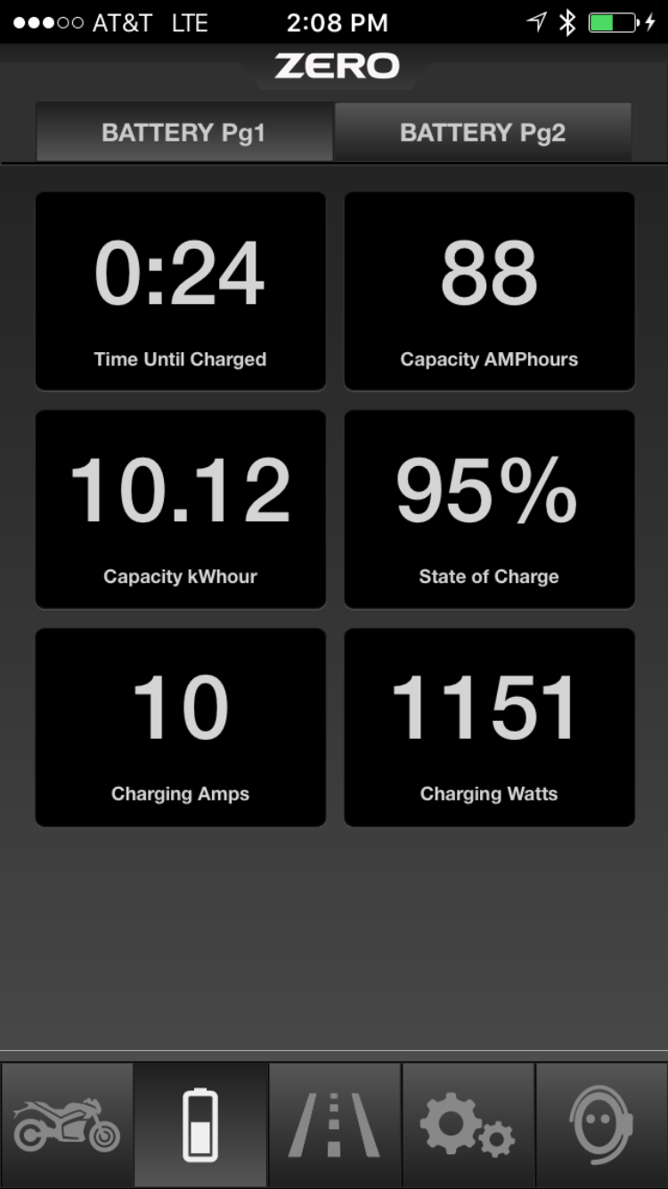

Re: Charging an electric motorcycle off the RV
Well that was short lived. When the bike pulls it's max 12amp/ 1250ish watts.. It trips the gri outlet by the bathroom. I'm tempted to see about a bigger gfi at Home Depot. The breaker for the outlets is 15amp.. I wonder if the gfi is too.. Or if they just get a little more sensitive with age.
I'll try a new 15amp gfi and see if I get lucky.. Using it to 20amp is probably unwise.
Update: new GFI seemed to work better. Bike was at 50% and charged without tripping it. Though, I may have been in a different cycle of the fridge which also runs through that GFI. Promising, but not confirmed as "good" just yet.
