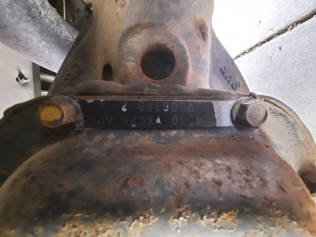

This is the tag on my 2000 Concourse (1999 cut-away) obviously I can't guarantee yours would be the exact same.
The casting mark indicates is a 70-2U
