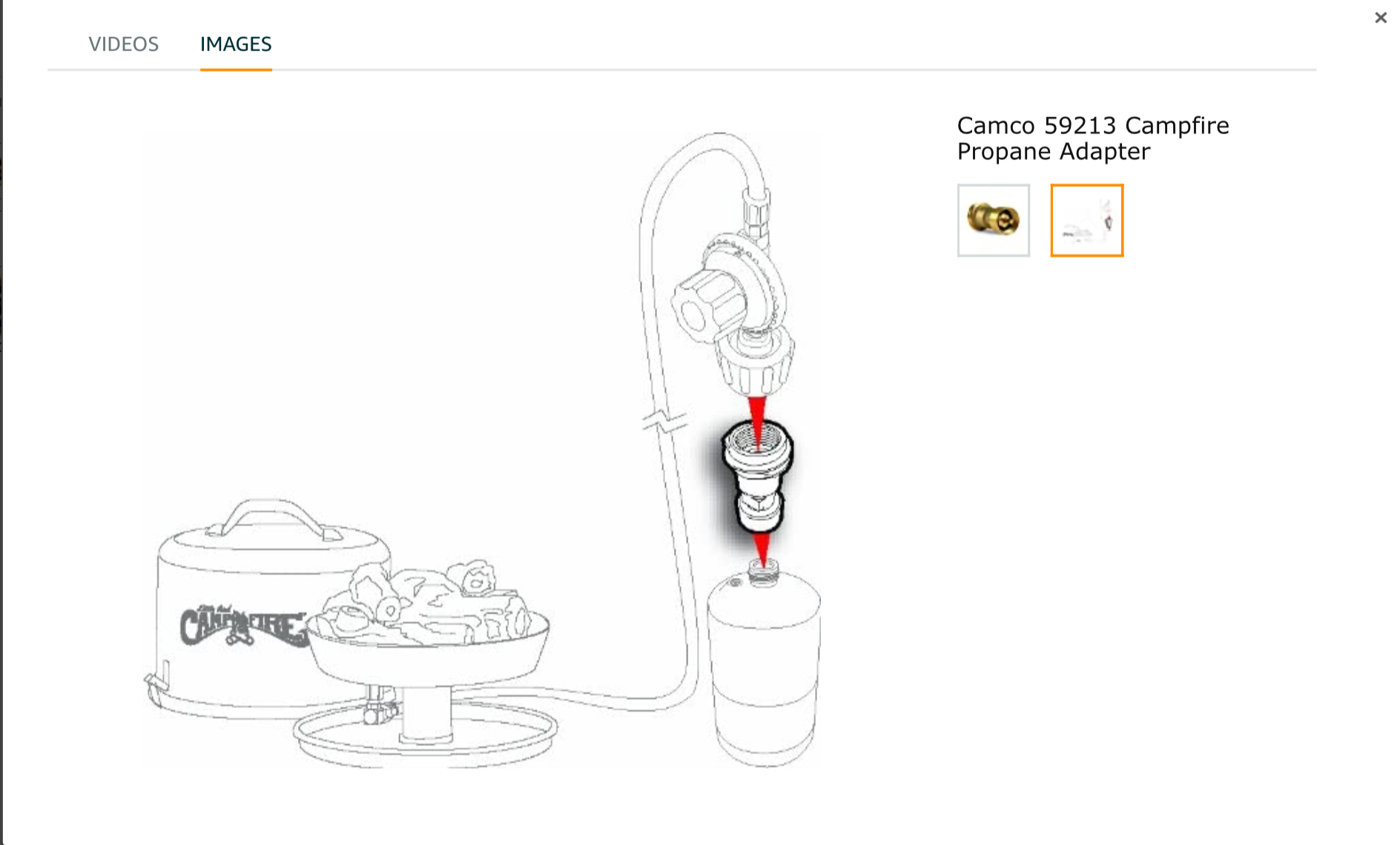

Update.......Here is the latest info received from Camco.........
The Big Red Campfire requires a fair amount of gas to get the fullest flame. You can hook it up to the 3 port tee (59103) directly but you will need the one pound bottle adapter to go between the 3 port tee and the Campfire regulator. If you use the hose that came with the 3 port tee then the one pound bottle adapter (59213) will go between the campfire regulator and the extension hose. Using the 3 port tee as the supply for the campfire may reduce the flame output. The campfire was designed to be connected directly to a propane cylinder.

This illustrates how to hook up a Camco Big Red Campfire to a 1 lb tank......

We purchased both Camco products and it works great! Nice flame and heat 😎
