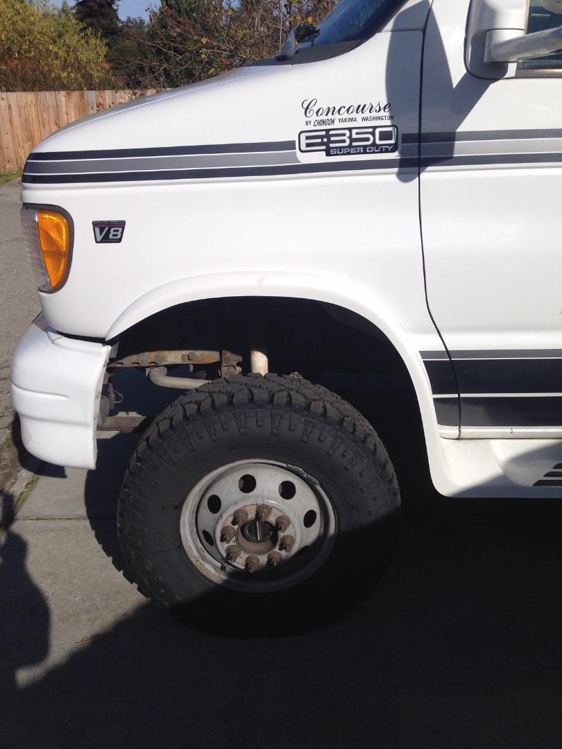

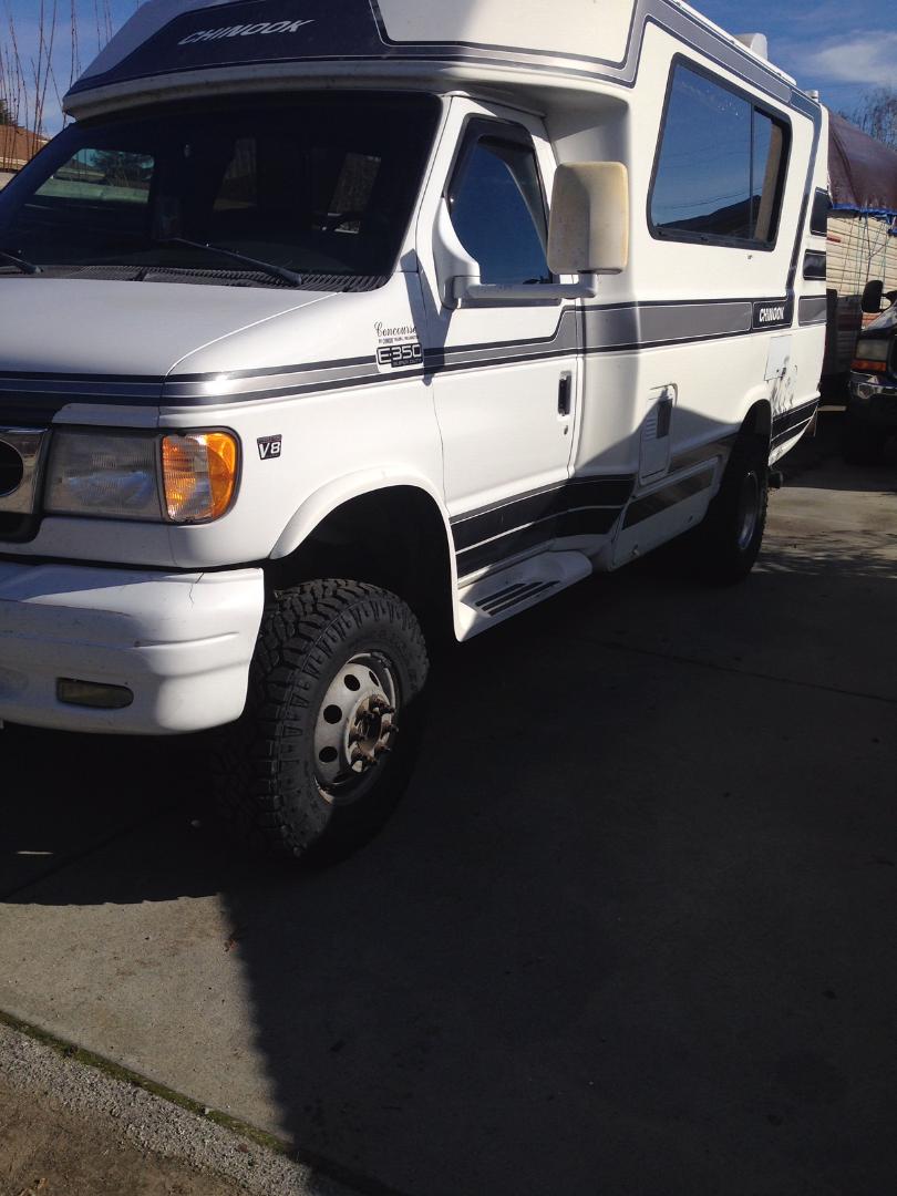

I have the LT235/85R16 Wrangler Duratracs on my 2000 concourse 4x4, They seem fit fine.

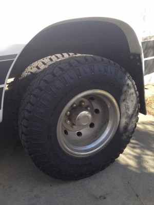

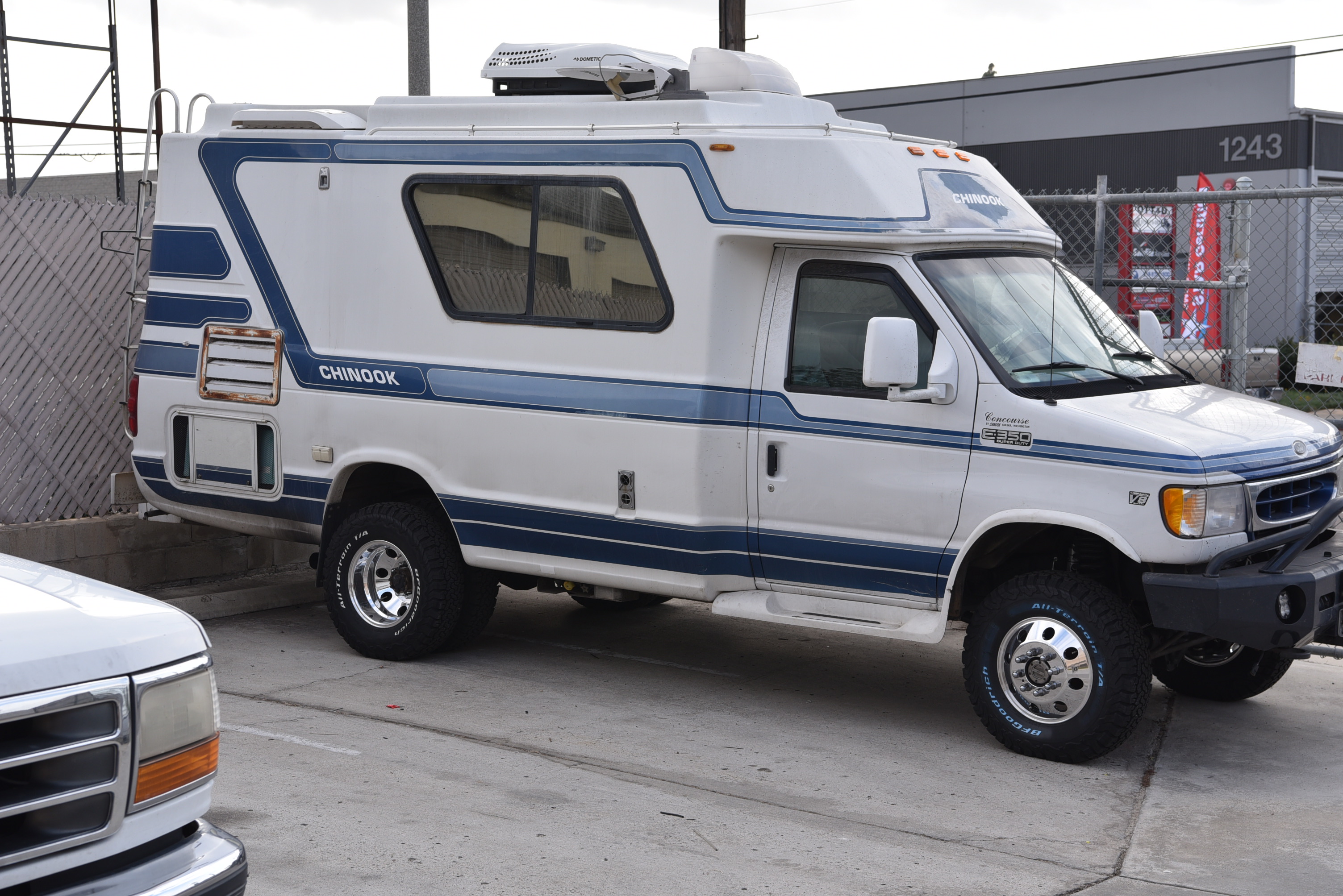

235x85x16 on alcoas ; 4x4 chinook

Those alcoa's just make that look so good..........what a difference from steelies
