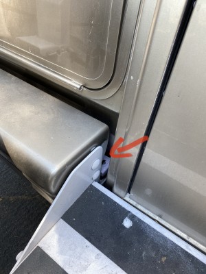

It took some testing to find the right placement for it, as I didn't want it to chirp when people were simply walking their dogs or cars passing, it's a tough balance because I want security but I don't want to be a nuisance to my neighbors. So after some testing I found this to be the ideal spot:
I did have to cover half the sensor in electrical tape to make sure it only detects what's in front of it and not behind. But now it is incredibly effective. It never chirps when you walk around the vehicle. But if you walk up to the step, or step up on it, you hear a nice chirp.

Not too loud at all. Just enough, and it has two settings for loudness in case you think it is. Plus the sound I have it play is just a single chirp that I don't consider to be too annoying a frequency. It's nice to be able to choose.
