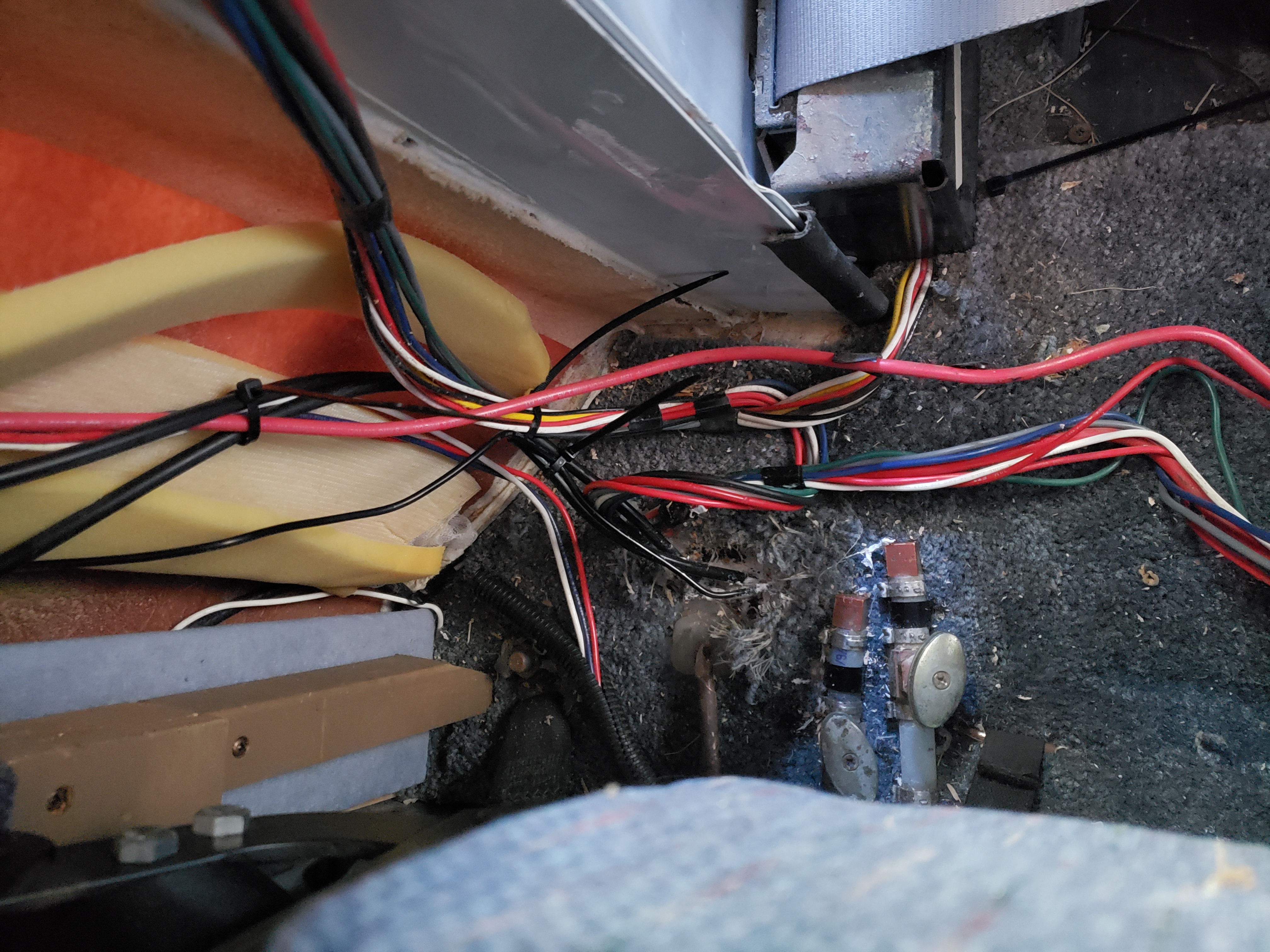

Now I must take back all the nice things I said about you in a previous post, since you had to convince me to remove that pillar again to install the battery temperature sensor. :) Additional reading into my battery manufacturer website (WindyNation) verified the need.
Seriously, thanks for the excellent discussion on the benefits of the sensor; removing and reinstalling the pillar went much faster this time since I knew the workflow. I drilled a new hole in the floor for the sensor connector and wire, and also a new hole in the battery compartment. All new wires were encased in surrounding silicone. I will keep an eye on these to be sure the silicone is protecting from chafing. Still waiting for the gland to arrive for routing the panel wires through the roof - hopefully Thursday .
I will attach a few photos so any prospective Chinook solar installer will have some visuals. Thanks again for your detailed information!
(click on photos for proper orientation and enlargement)
Pillar partially removed - access gained to work area
Magazine rack and bed side panel removed
Wires run through floor (difficult to see)
Wires from below into battery box
