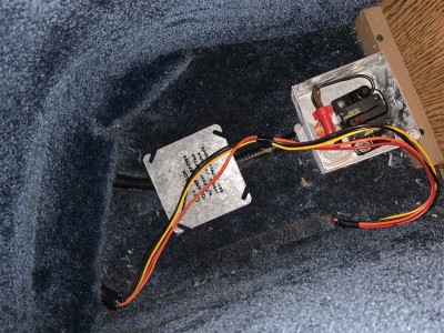

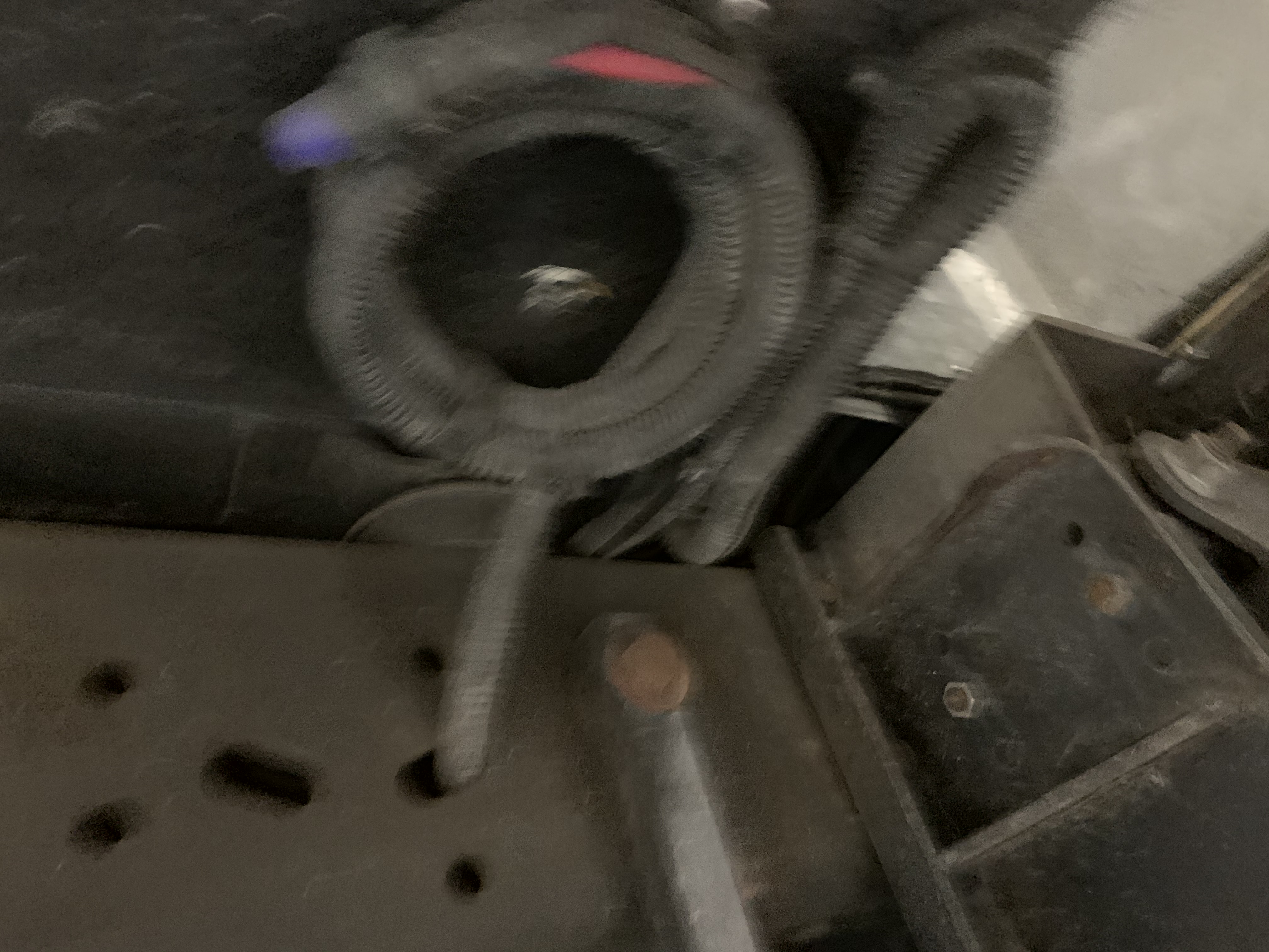

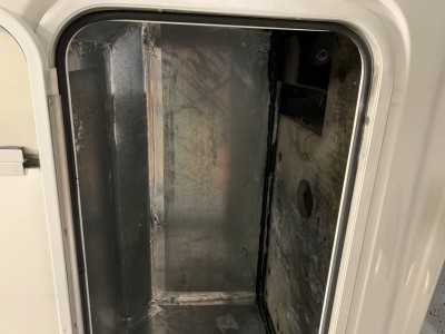

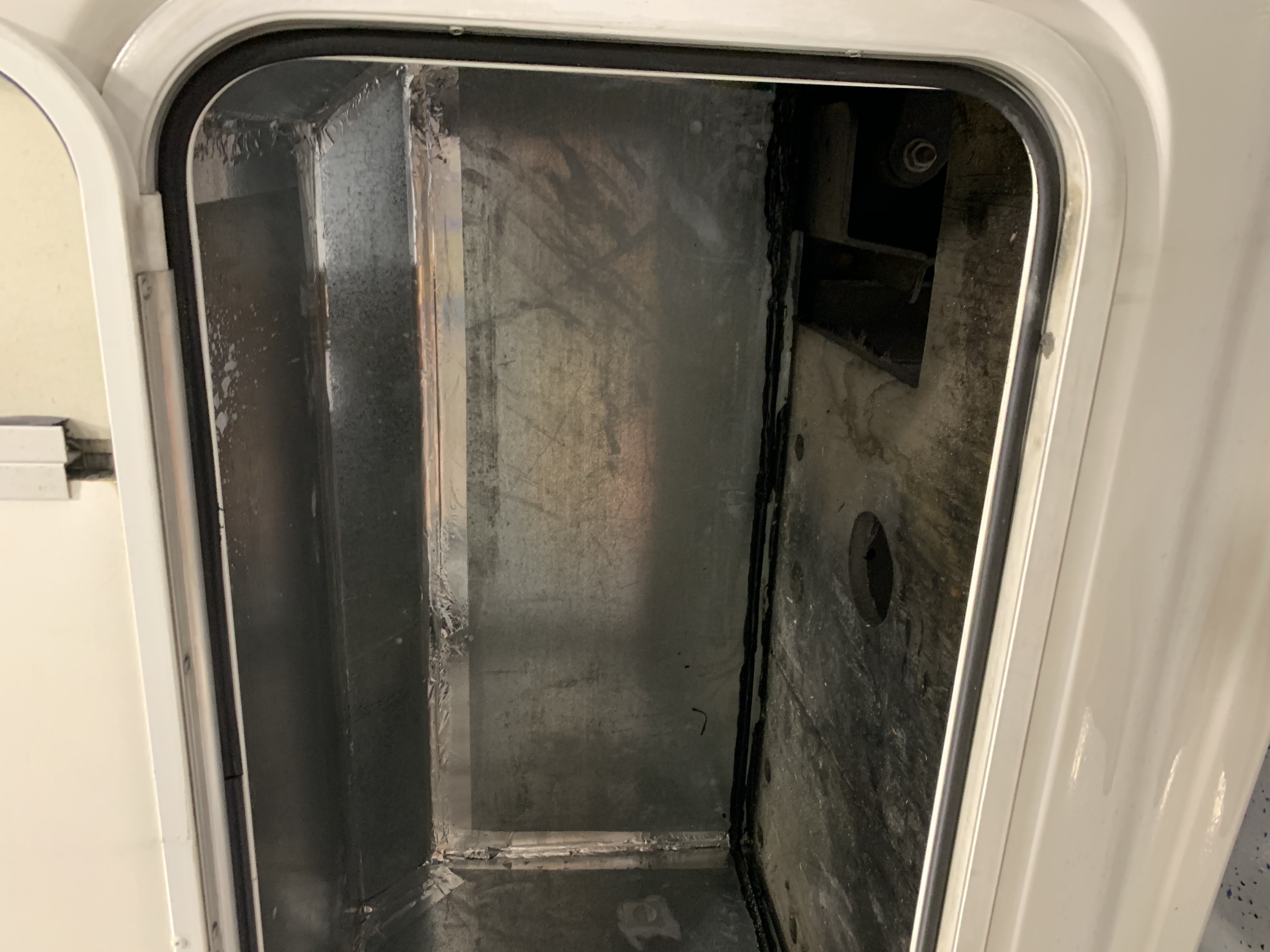

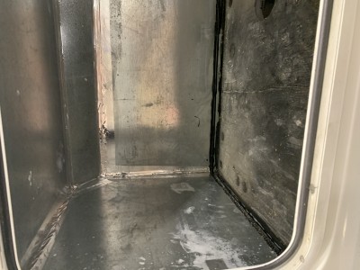

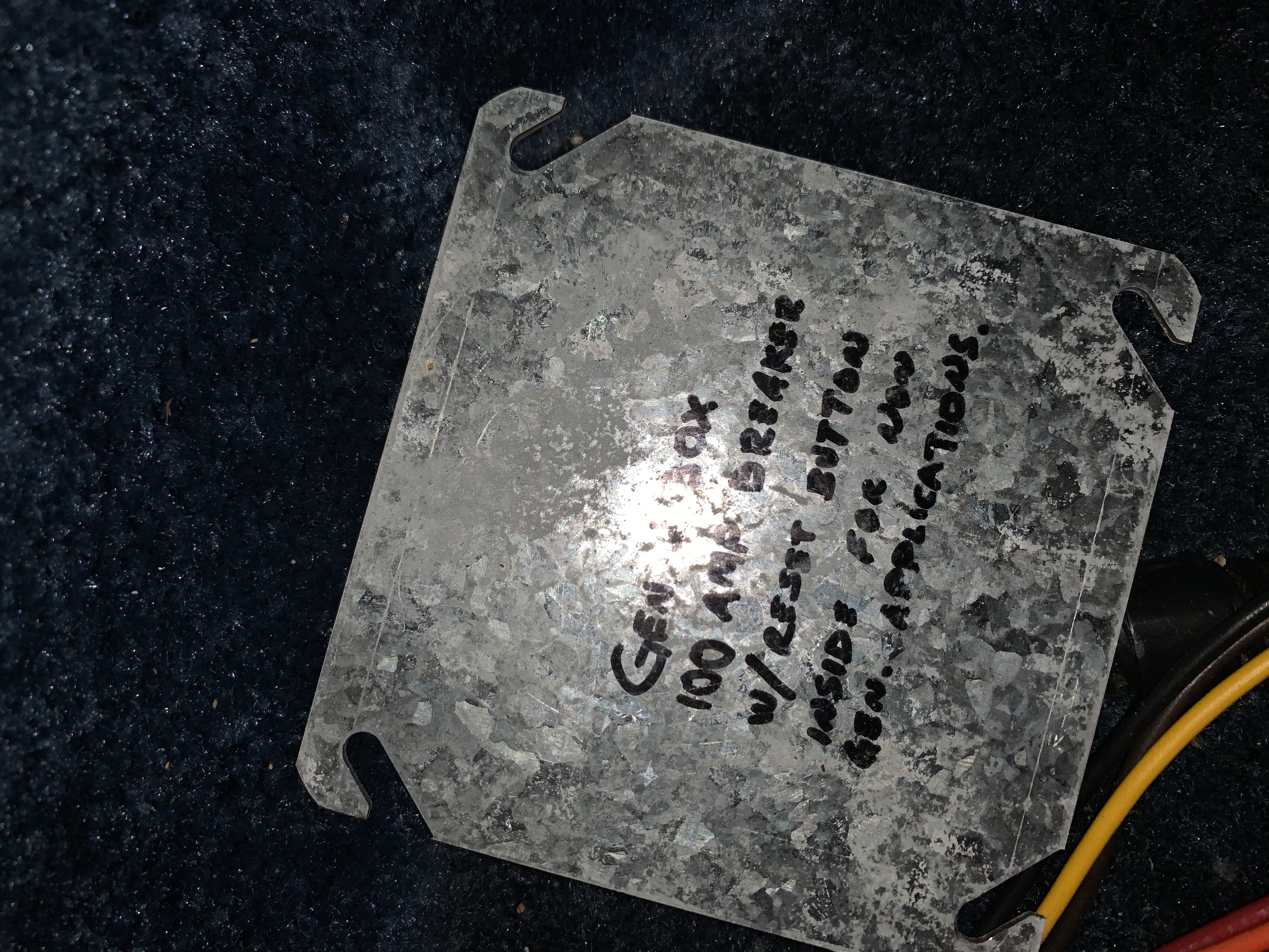

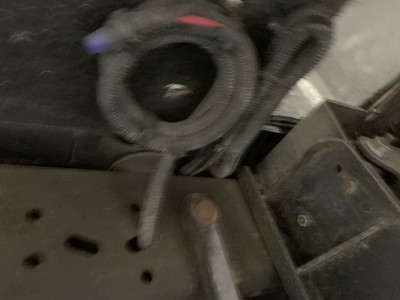

As an update - here are pics - it appears the factory prewired and prepped for it including gas line - the build sheet confirmed it came without one -
Re: 2003 Chinook Premier - no factory generator
That is good news. How about wiring for the remote switch near the driver seat, wiring for the remote by the closet near the smoke detector? The one by the driver seat can be a pain to fish the wire if Trail Wagons did not have the wiring there already.
