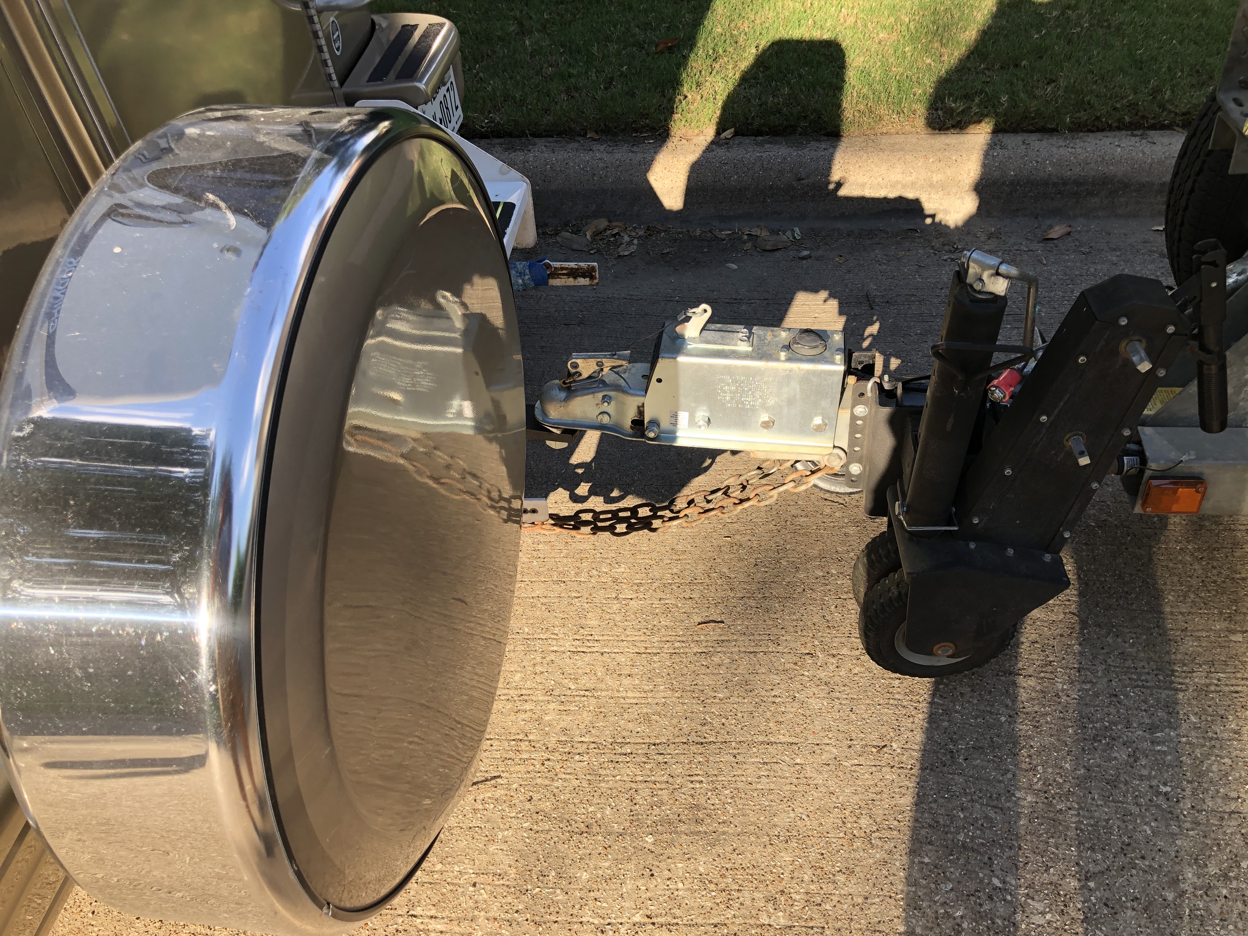

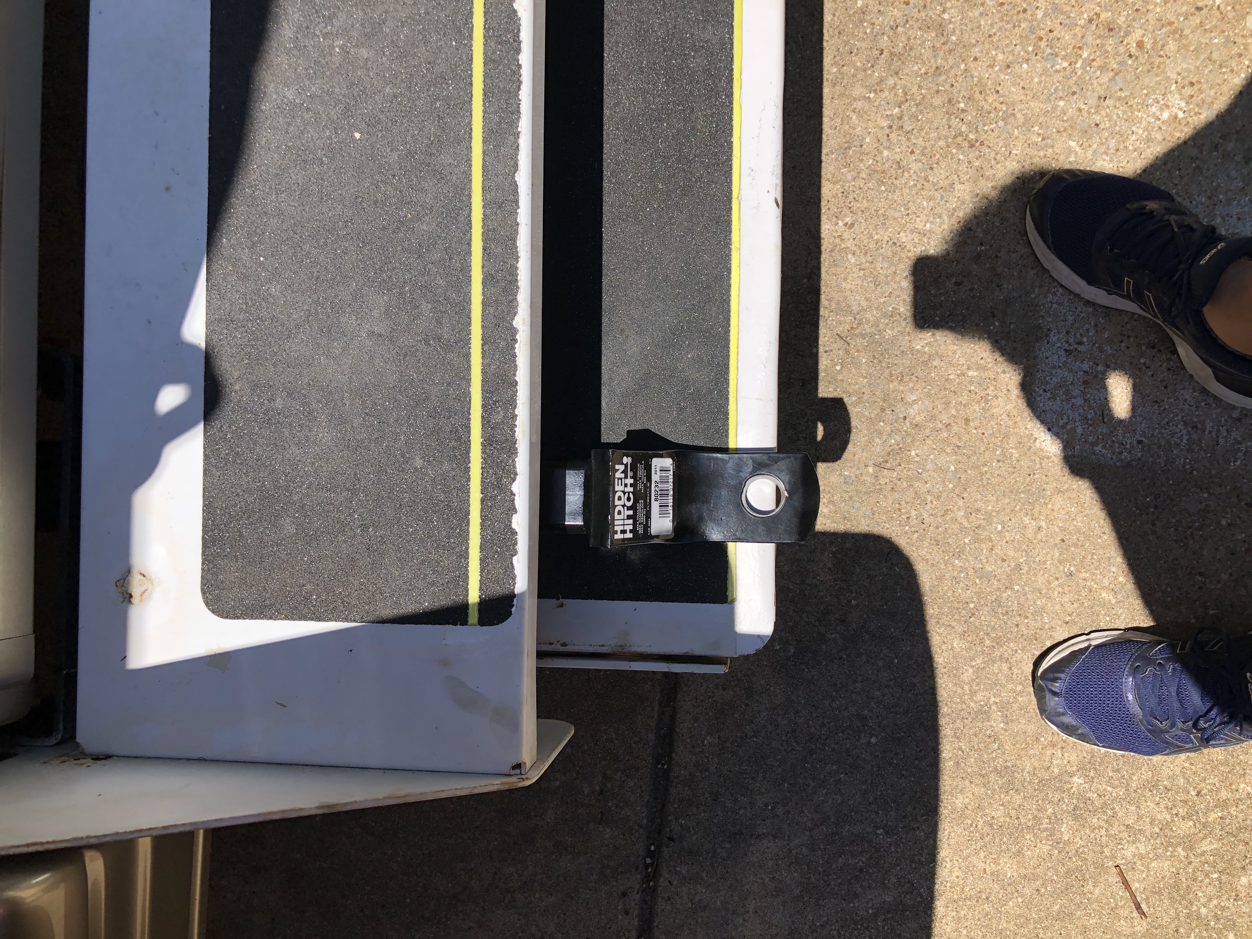

I find that that from the pin hole in the receiver to the end of the top stair is 10". The 14 1/4" Curt receiver that I mentioned (CURT ball mount for 2" hitches - 4" rise 6" drop) Model 45280 comes out 8 1/4 inches from the Pin hole where it starts to lower (rise) to 6" drop (4" rise). I had hope that others used this ball mount, to determine if it that rise (still 1.70 inches from the top of the ball mount to the bottom of the stair) clears the top stairs. I am still working to obtaining a raised ball mount (local shop has the Curt 45280 on order) than I can attempt to fit, and confirm it will work.
Thank you very much for your suggestion. I am still working on cutting weight.

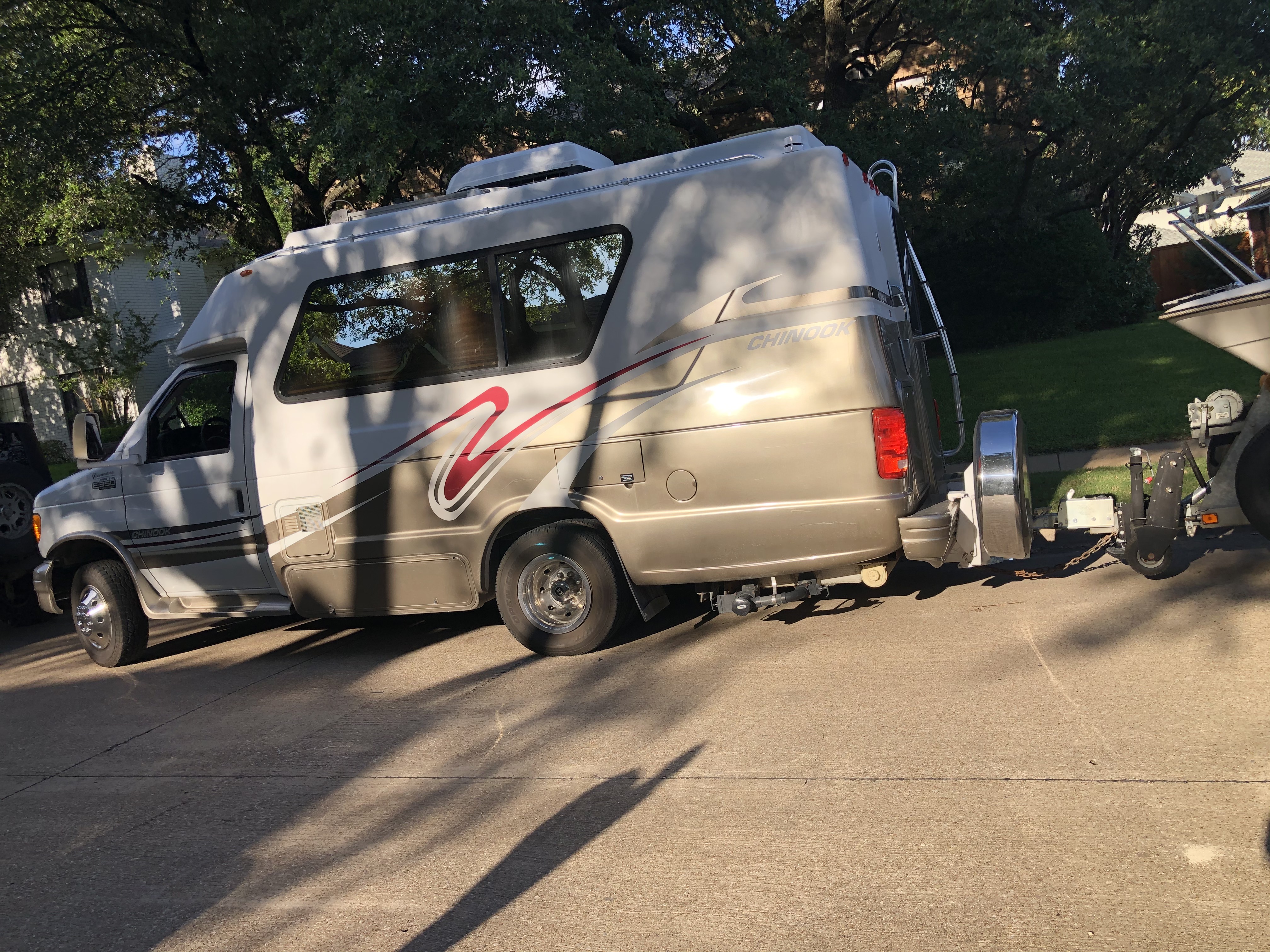

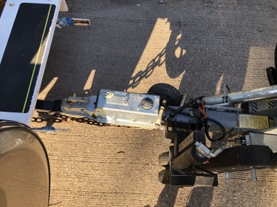

I have attached pictures of the ball mount and several with the boat connected to the Chinook.
