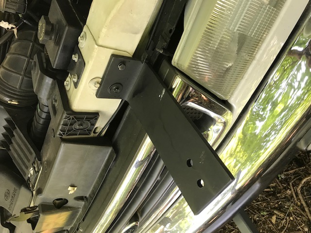

As promised, here are some pictures of the mounting brackets and Snow Plow Headlight Assembly that I have installed so that I can have DOT certified headlights when I am running with my bicycles covered and mounted on the front rack. I'll have the wiring done by one of the local Snow Plow Supply and Service Companies...or my local Ford mechanic (can't decide which).

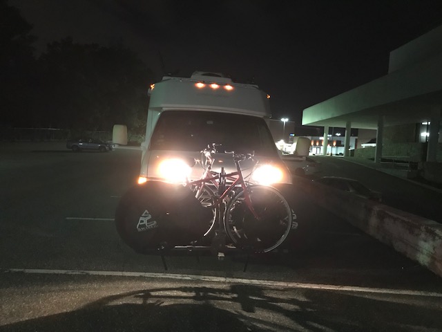

I completed the wiring (had a local aftermarket company do the work--excellent job, only $160 bucks) and took the Rig out for a test drive yesterday...very happy with the results. The bikes are now mounted up front with the covered rear wheels outboard and Skinz Bike Covers covering the back wheel and crank so as to leave air flow corridor to grill open. All of my temperature readings are good (192-197 water and 175-190 on the transmission fluid temp). Vision with mounted plow lights is also excellent...actually better than with the regular lights. So, it has taken a while to get here--having to deal with cooling and lighting issues along the way, but I am ready for our next cross-country trip to Idaho and Oregon in September. I am attaching three pics (one with regular lights, one with plow lights, and one with bikes mounted shot from front) to give you all an idea of how things turned out.

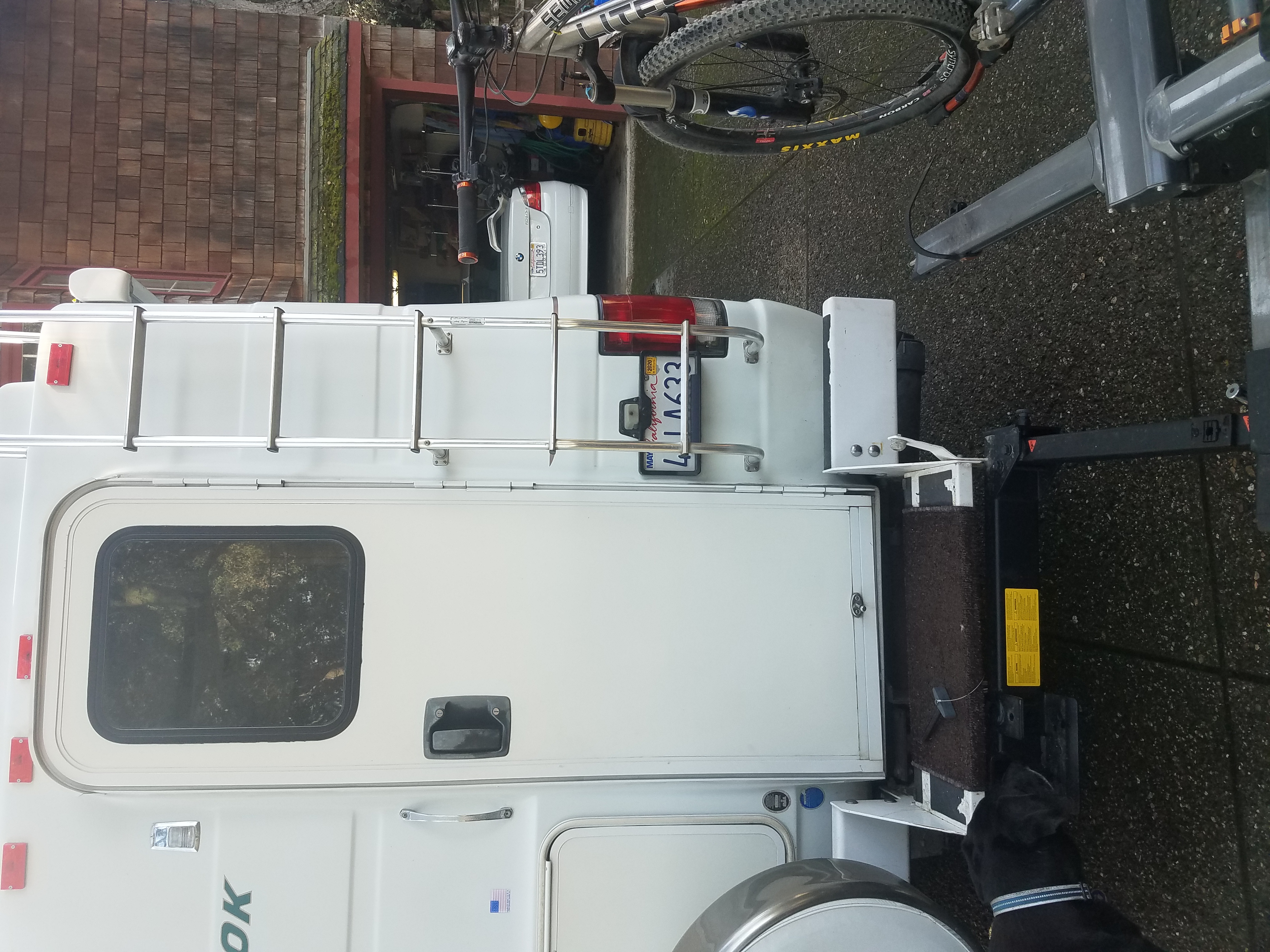

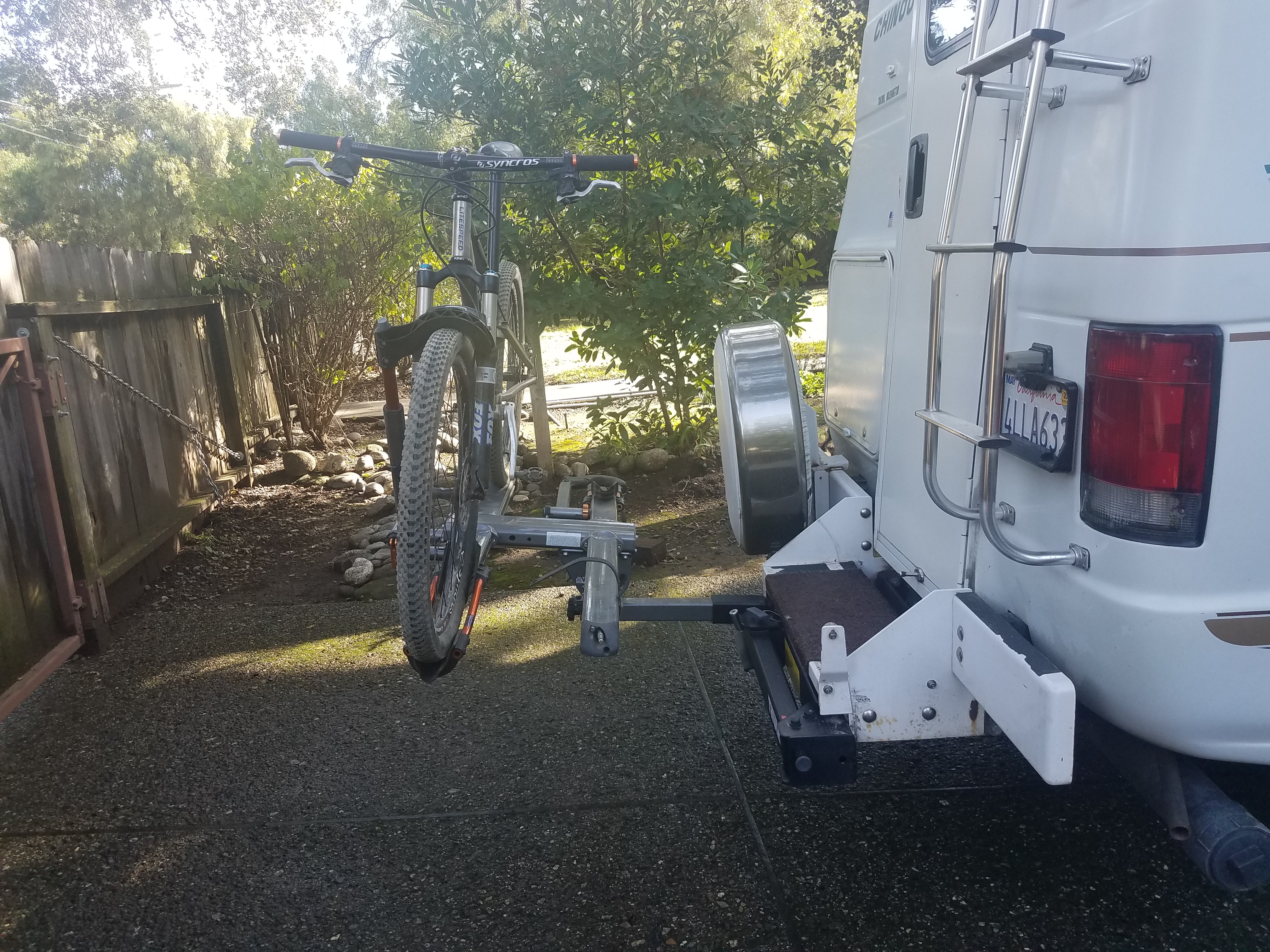

LosLaureles
Posts: 55
Re: Bike Hitch Rack
Post by LosLaureles »
Finally took photos with one of the bikes on.
