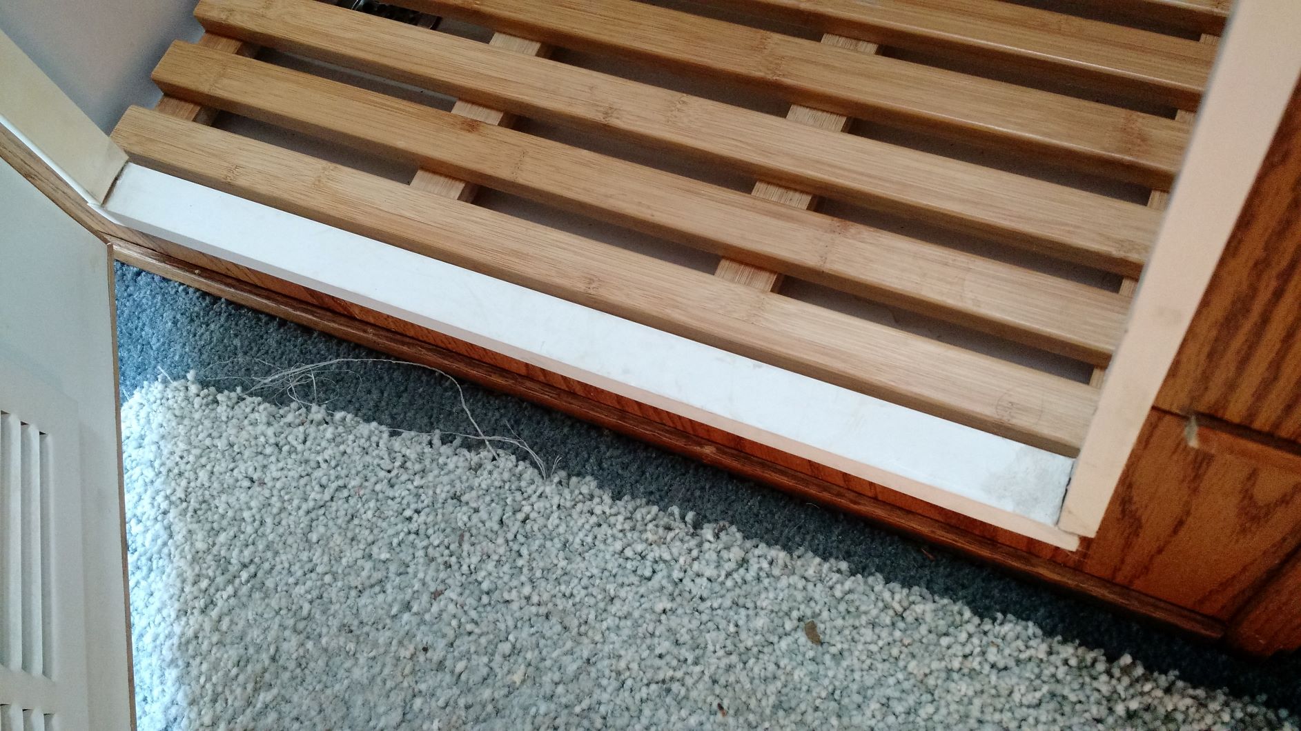

Another option is to use solid oak, which is what I used to repair my MDF. My repairs were limited to about 2 to 6 inches from the floor, so I glued oak scraps to make the repair pieces, and stained with "golden oak" stain and varnish for a matching finish. You can find solid oak furniture at thrift stores for cheap, and you can buy hobby size pieces as well. I used some old drawer fronts I got at a recycle place. Where the seams were noticeable, I just cut some oak molding and covered them. Since there is already a lot of trim in the coach covering seams, it doesn't look bad.
Here is a sample repair, the bathroom door sill:
The solid oak with a coat of varnish is pretty much water proof.
