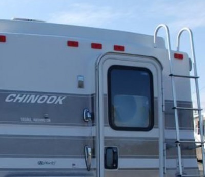

Plastic/vinyl piece on inside rear door window
What is its purpose? Can’t see out of it very well from the inside. Guess it somewhat provides privacy from vehicle travelling behind. Is that it? Thanks
Re: Plastic/vinyl piece on inside rear door window
Looks like one of the self stick wide angle prisms designed for seeing better out the back to me. Wouldn't work on mine as the window seal has failed and is fogged. lol I had one on my 24 Tioga years back and it worked pretty good.
Thanks SMan. Thought that was likely what it is for but it only seems to blur the view. Took it off and the window is nice and clear. Time to check out rear view cameras.
