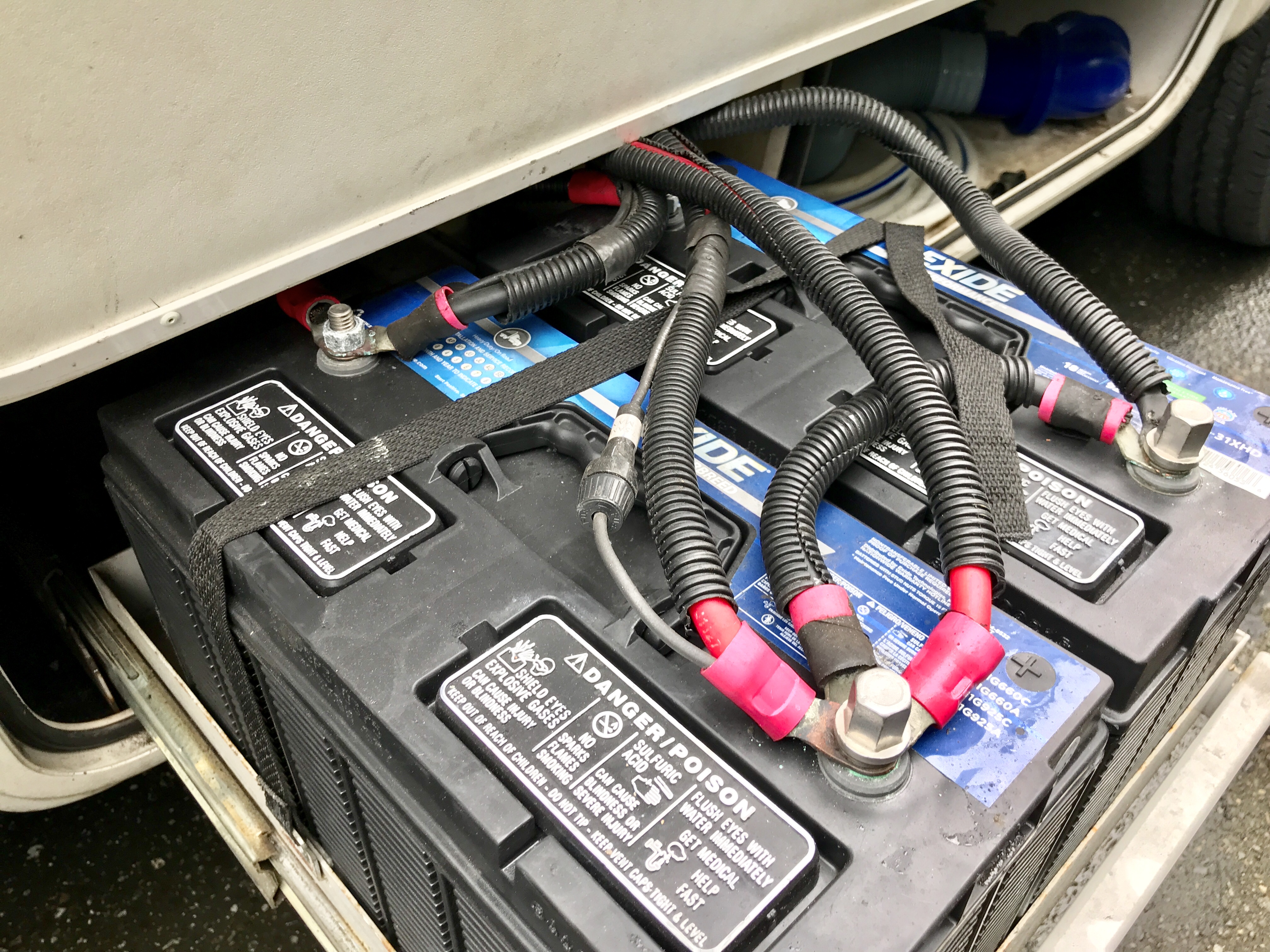

What do you guys used to pad the batteries in the tray? Since the battery is smaller than the tray, there is a piece of wood that the previous owner used to keep the batteries in the outer left corner. The wood has some rot, and the battery acid seems to be soaked into it. I can easily make another one but want to know if any of you have a better alternative. The first change I am going to do is to keep the batteries in the center of the tray. The clamp that hold them down is digging into the case right now since the left one is right against the tray lip where the clamp is. Another thing is that I have these foam that I can easily cut with a pair of scissors. Don't know if that can be used instead of wood.... it may give the batteries a bit of cushion, and I don't know if that is good for the batteries if I go driving on rough road.

FWIW, my tray has no blocks or padding. There is a strap that hooks into the tray and hold the batteries down tight.
Re: battery tray insert
The strap that comes with rig is like 1.5 inch wide. It is very strong material, but I don't think it will stop the batteries from banging against each other when the rig is moving. I have gap all around the batteries if I put them in the middle of the tray. Considering the weight and the amount of energy it has (kinetic, electrical, and chemical), I want to make sure it is as secure as possible.

Mine have the tight strap that is so secure that I couldn’t move those batteries at all by hand. The batteries have a kind of plastic bumper build into the bodies so that there is no “gap” separation to speak of. They seem to take up all the space on the tray as well, so no room to move around or slide.
Also I find that all those cables attached are so stiff that they give a certain firmness to the whole unit.

I just installed a new pair of VMax 125 AH group 31 AGM batteries in the drawer of my 1998 Premier. They fit well with a wood spacer at the back and in between. The latter space is where a 500 amp shunt for the Bogart monitor sits. Now to troubleshoot my 200 amp solar panels...
