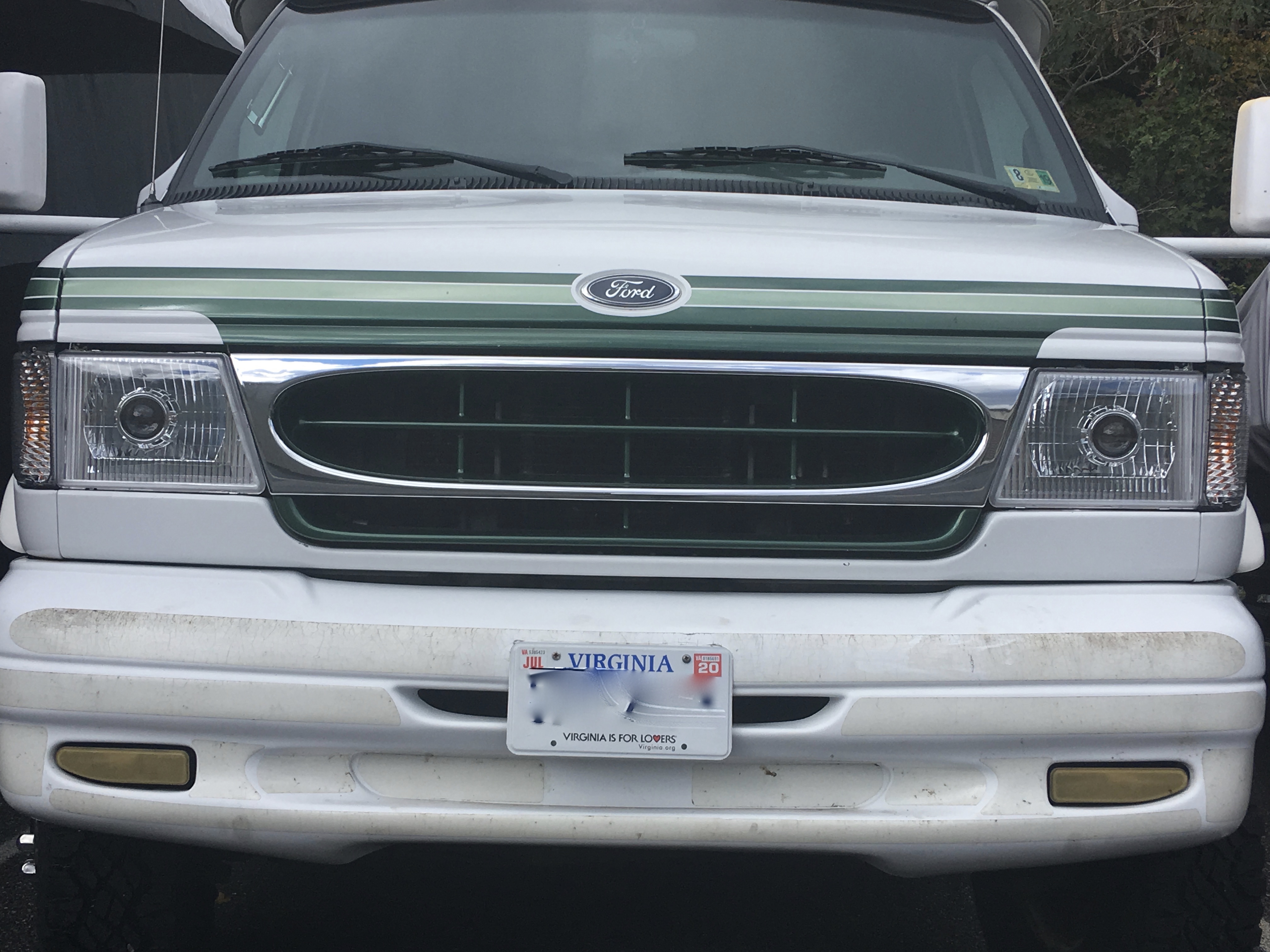

I installed Optic HID headlights recently, took first trip with them and love 'em. Headights have that distinct light line, similar to wife's BMW. Highbeam is long, wide and bright. I have 2001 e-350 and difference for me is very noticeable. Spent 4 hoursdriving backroads in dark and rain and I would have hated that in stock lights.
Here is what they recommended for me: The Basic PNP kit is a perfect fit for your needs with the 9007 harness and no need for the sealed beam conversion kit.

68camaro, where did you get your lights from?
I feel mine are adequate for my use, but when I really start doing things with the rig, I want something a little better.
Re: Projector Headlights
These work great and very happy, one connection did come loose so I had to tightening back up but no problems since, vendor very easy to work with.
https://www.vantageoptics.com/shop/Ford ... p105191030
SKU: #10133
Housings: Chrome, Projectors: Morimoto Mini H1 7.0 (2.5" Lens), Shrouds: Mini Gatling Gun Round Chrome, Ballasts: Hylux 35 watt CanBus, Bulbs: Acme H1 5000K (in stock), Wire Harness: 9007 Plug and Play, Sealed Beam Conversion Kit: No, LED Turn Signal Kit (bulbs/relay): No, Spare Generic Bulb (single): No, Spare Generic Ballast (single): No, Install, Ship or Pick Up: I want them shipped to me
