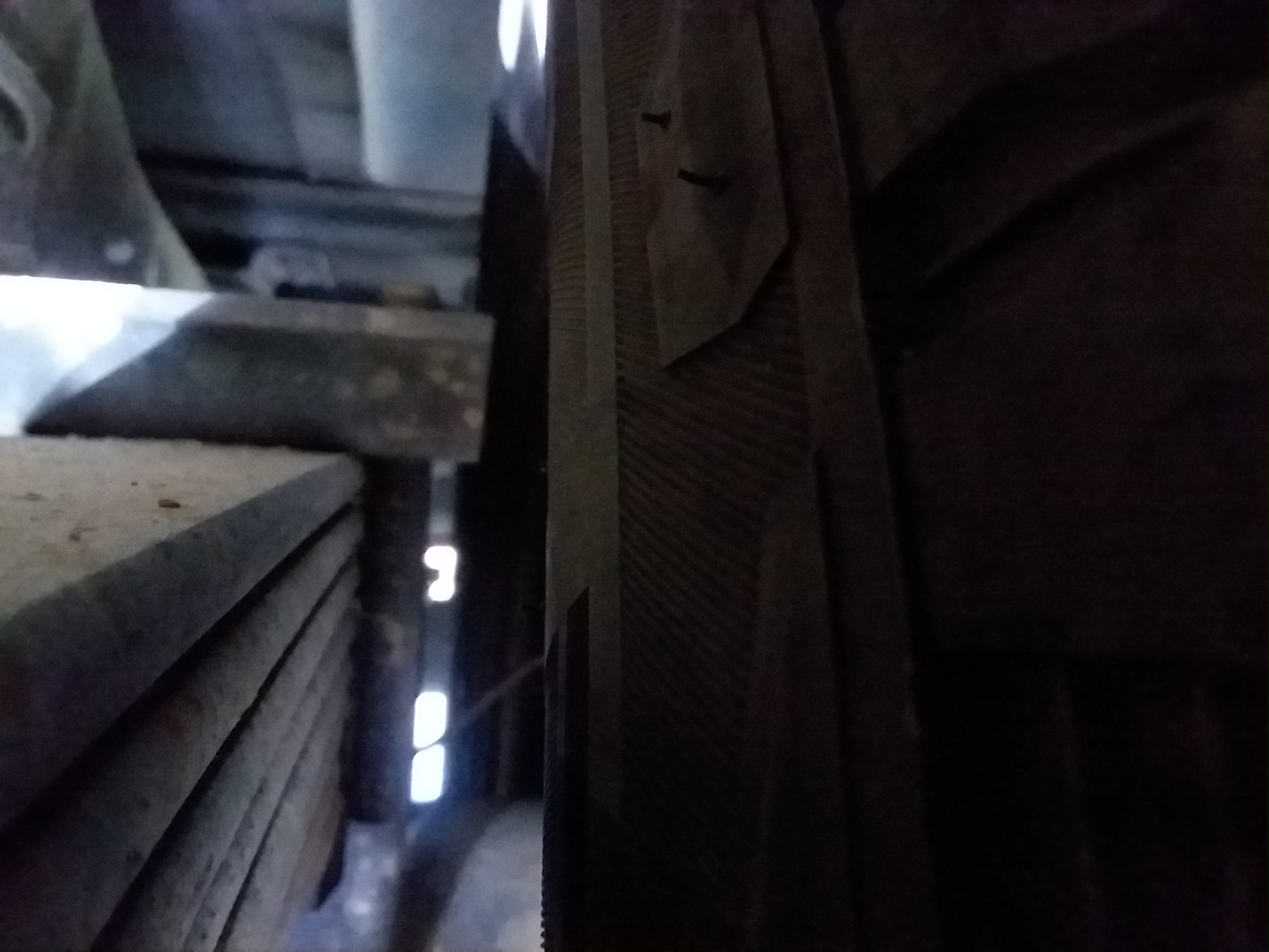

I'm pretty sure blocks of that height won't work on a DRW Dana 70 E-350. The upper retainer plate will contact the tire. I have to credit Mark Atherton for bringing this to my attention.
I just took this picture (wasn't easy!) but you can see what will happen.
Single rear wheels are different.
Thanks for pic, that is a concern. To avoid this vendor thinks we can go with a 2" block plus gain one inch by adding one add-a-leaf to equal the three inches I'd get after compression of the vendors 4" lift kit. This will also be workaround if I cannot add new leaf spring pak to MorRyde. Before deciding I am meeting with installer to confirm plan, I feel I am being rushed due to necessity of needing new tires ASAP.
If it helps, I just measured the clearance, and even just two inches (block and/or add-a-leaf) would put the edge of that plate within millimeters of the side wall. It looks too close, at least from what I'm seeing on my rig with the current stock-size tires and no MorRyde. More arc would be the way to go ...
