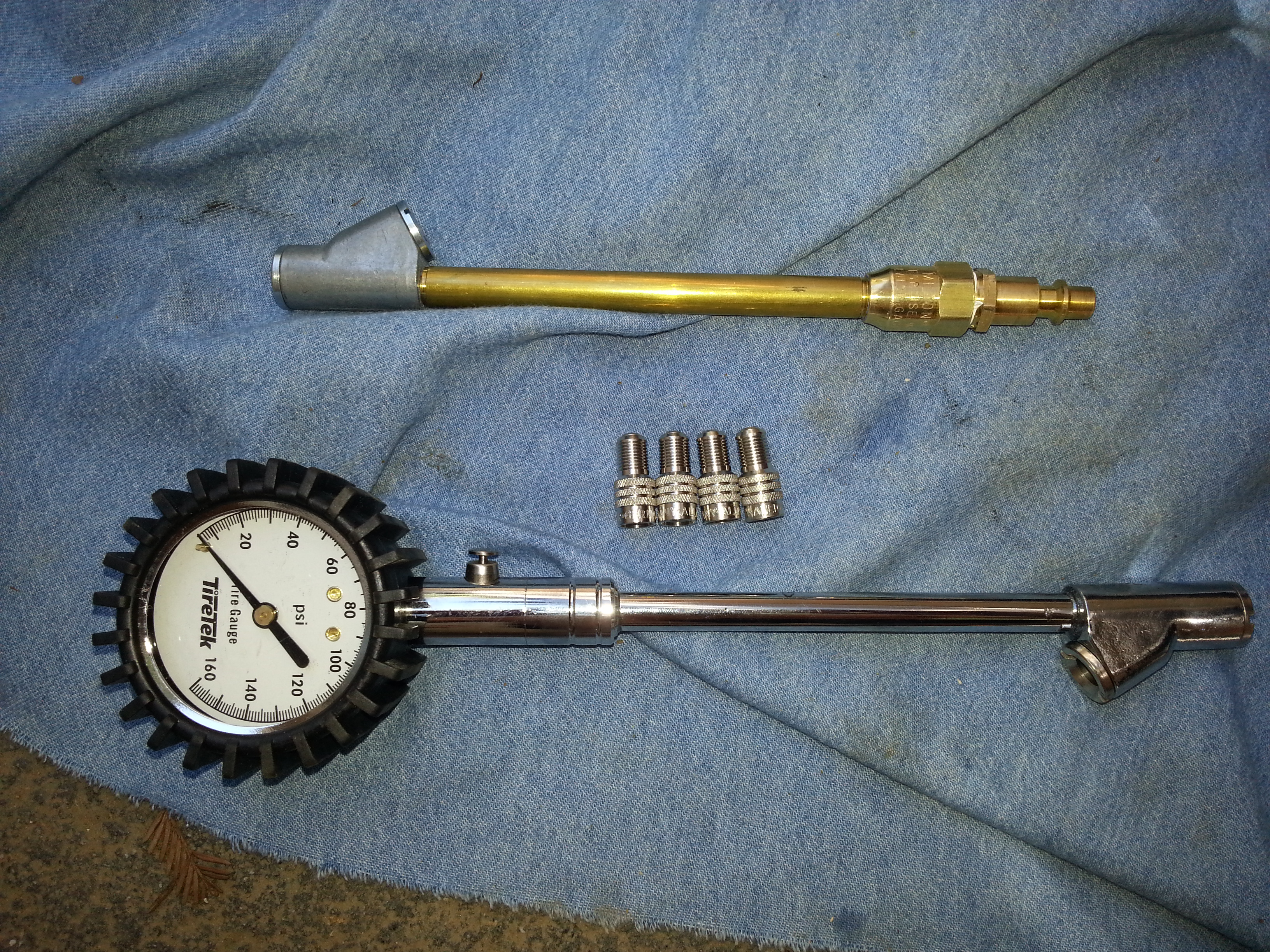

I know this thread is about extended valve stems (slick setup!), but I just wanted to throw out another approach if you can't find someone you trust for the installation. I use the blow-thru stem caps (the good German ones) and an extended gauge with a dual angle chuck. Checking tire pressure is a snap, and there are no braided hoses flapping in the breeze. I don't have simulators so I don't know if that would change anything.
