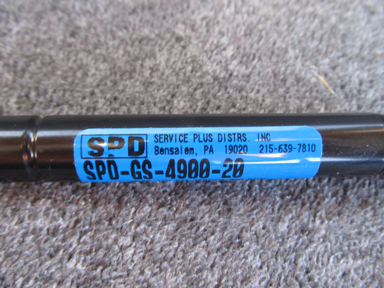

When I bought my 1999 Concourse, none of the overhead cabinet doors would stay open. They all "drooped" due to aged original struts. This is common with this type of strut (on other RV's as well). The original struts on my rig were SPD brand (blue labels). The five smaller cabinet doors had 20# struts, and the larger forward door had a 30# strut.
(For those who have different Chinook models, the cabinet doors on the Concourse of my era and later have overhead cabinet doors that are hinged on the top, open "up," and are held open by gas struts, something like a car hatchback.)
I replaced them with similar struts of a different brand (I can't remember why exactly - I think it was because someone had recommended them, and I'm not sure I even knew the SPD were still available). Here is one of the ones I replaced the originals with:
Replacement was an easy, five-minute job. If I remember correctly, you do something with a screwdriver to open one end cap and then the other just pulls off, then the new ones pop on, following the orientation shown on the strut itself (for which end goes down).
I went with 20# struts for the small doors and a 30# for the larger door, but then the larger door strut didn't really work all that well at holding the door open. It seemed defective. However, the place I bought them from recommended I go to a 40# strut, and said they thought perhaps Chinook had done the same thing in later years (not sure if that is correct or not). So instead of sending me a new 30# strut, they sent a 40# version. It works fine, and is certainly "snappy." Thus, I'm not sure if a different 30# strut would have worked well. The folks were friendly, but it took a bit of time and a number of communications to get the replacement strut. I don't have the information to hand about where I sourced them, but I see they have them on eBay, and the name of the store matches the URL on the strut (although the URL itself, http://www.strut-your-stuff-here.com, doesn't lead to a functioning website for me).

Going by the part numbers, it looks like those should work for all of the "smaller" doors (i.e. all but the center front door). That looks like the same part number as the originals, plus the "NI" which looks like it's a coating that they probably started applying after Chinooks were made (just guessing).
Those are 20# struts (hence the part number ends in 20). That's what was used (and what I replaced with) on all of my side doors and they work perfectly.
The front door originally had a 30# strut, and I replaced it with a 30# strut. The replacement didn't work very well and I tried to get another 30# strut as a replacement, but although the company was "nice," each communique took forever to go back and forth. Thus, when they suggested the 30# was probably too small, I went with what they offered to send, which was a 40# strut. That works fine, although I suspect the 30# would work fine too and the one I got was just a dud. But at that point I just wanted to get it over with (months later.... )
I did see where another Chinooker put a 50# strut on the front cabinet door - because he mounted a flat screen TV on the door so needed extra lift. I wouldn't go over 40# with nothing on the door - just seems like too much force, and would probably still try a 30# if I ordered anew.
