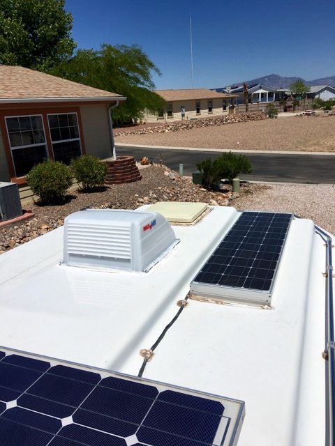

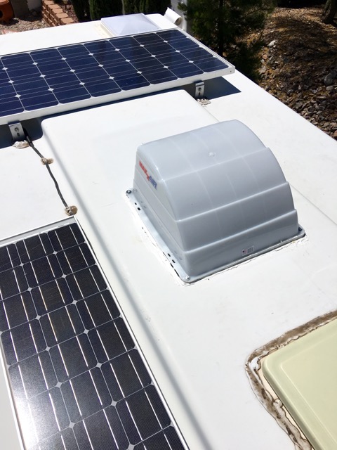

Meanwhile, it rapidly became obvious my skylight transmits too much heat, even with the grille. So my final mod today was to add an external Maxxair vent cover for insulation and UV protection. I was cautioned only mad dogs and Australians go out in the midday sun!
Installation was trivial after fighting tacky caulk residue to line everything up. I drilled four holes in the corners of the cover flange to match pre-existing holes in the skylight. Roof clearance is back to where it was with the A/C but I dont mind the fresh profile.
The pictures also show the second solar panel mounted aft that I have to skirt around exiting the ladder. Now to rest and contemplate the microwave cabinet mod.

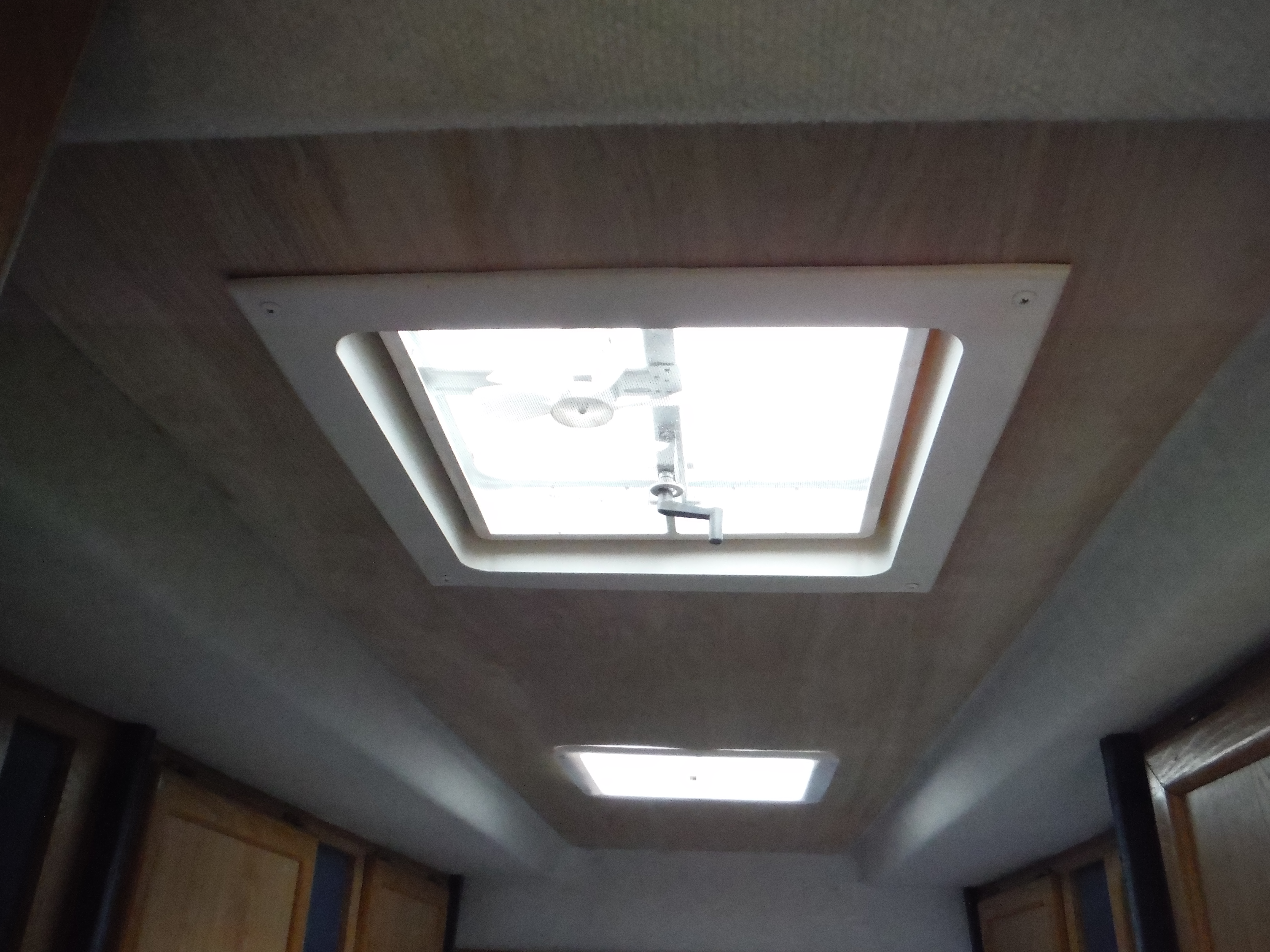

Rover... For skylight insulation, I just press into the garnish a piece of 1/2" Rmax (shiny side up). Works very well and is only warm to the touch at high noon in summer. It doesn't look "finished" but it's only used on rare occasion. Might not be enough in AZ, and I see you've already installed the grate, but thought I'd mention it. Side note: I'm going to re-try a glass piece for my skylight once I get some time...

Since I do like to look out and get the non-tinted light in I basically do as Scott does, but just with a piece of foam board instead (and Reflectix is a good idea - should have thought of that as I already have friction-fit pieces for the three cab windows, but for some reason I didn't...?).
The sideways solar panel install is interesting. Can we see more? Photo from the ground?

To answer BG’s question about my sideways solar panel, it is an AstroPower 120W addition the previous owner installed to supplement the original 50W Siemens panel. The installer neglected to upgrade the 7.5A fuse to the house batteries and I will save the consequences from that oversight for another “Tale from the Far Side.” For now I attach a perspective from the ground as requested.

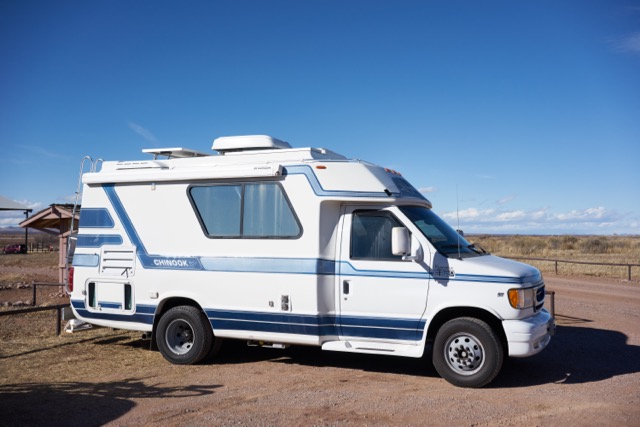

Thanks for the photo - our Chinooks definitely look like sisters (except my year has the stock Ford front bumper vs. the Chinook fiberglass one). I *still* haven't mounted my roof solar panels (geez, the sun will have gone red giant by the time I do that), and although I think I'm just going to go with the slight overhang of the main tier, I have played around with other placements. But nothing beats seeing an actual photo, looks-wise.

I wanted to thank you for this simple idea. I had some foam board I'd use for the same purpose (generally in June/July with high sun, presuming I have not found some shade to camp in). But your idea sounded better, so I cut a friction fit piece of Reflectix (the foam board needed some tape "help" to stay up). The new way is perfect! I can even "taco" it a bit if I want light on one side of the room but not the other.

The glory of my skylight has remained topside only. I had a flimsy plastic garnish trimmed to size in there for about a year, and it has been OK aesthetically, but it turned into a spider/fly/dust trap. I had the inner flange almost up against the skylight (a very slight gap about .050"), but the garnish has warped from UV and heat, now stuff can get up and over the flange. Hope that makes some sense. For quite a while, I've had this grand idea of covering my hull liner ceiling with a sheet of quality wood laminate and casing in the vents with wood trim and ditching the plastic garnish rings. I got the panel shaped and installed, but before I could trim out the vents, the panel fell down. The ultimate insult. Even at 1/8" and very light weight, sticky backed velcro all around wasn't enough. Looks like I'll need to screw it to the roof. Program change. Here's what it looked like for test fit with plastic garnishes (forward garnish a bit warped) before falling down in the middle of the night.
