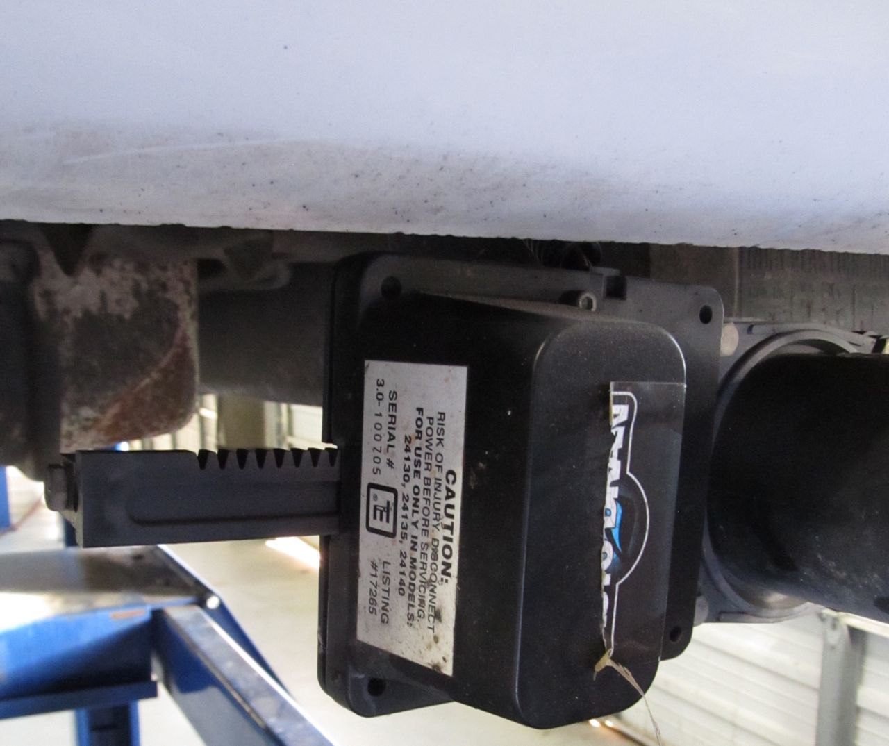

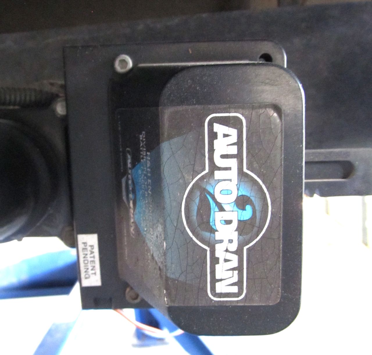

Auto Drains look like. There is one on each valve (grey and black tank
drain lines).

Looking at the back side, you can clearly see how it is just a small motor attached to the regular old manual valve with a metal plate, and then there is a plastic "arm" that pulls the valve handle in and out. I simply removed the two fasteners that held the plate on, plus the one at the end of the arm, and... good-bye
Auto Drain.
There are wires attached to each
drain (they are quite obvious, although it takes a bit of care as they are in wire looms along with other wires, such as the ones that lead to the tank sensors). The two switches for the drains are on the forward wall of the compartment that holds the electrical cord (right by the compartment door). They are also easily removed (although I forgot to photograph them).

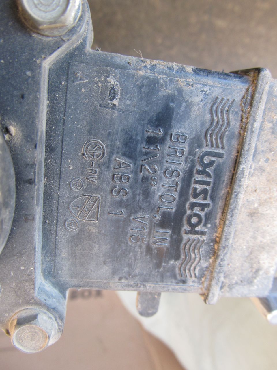

So, before removing the old valves, I wanted to have new ones on hand. I noticed that the Chinook did not have the ubiquitous Valterra valves, like my last rig. Instead, it had unkown to me "Bristol" valves. I had to do a little bit of hunting to figure out the new part numbers for valves to match (the attachment fastener pattern is slightly different than on other brands).
I now know that these are made by Bristol-Lasalle, and they are not impossible to find, although you don't tend to see them at every Wal-Mart or hardware store with an RV aisle. That's one reason I decided to just replace the whole valve, plus stock a set of replacement seals for both valves. Here is the new part info:

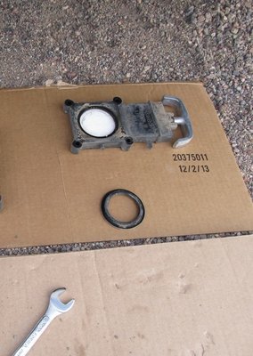

The valves go in between these two pieces. I was boondocking in a gravelly area, so used plenty of cardboard and plastic etc. to keep a clean work area (the valves need to stay grit-free).
What is a little bit trickier on the Chinook is that you have to get all four seals and both valves on, plus the removed pipe section, and then the eight fasteners -- without disturbing the placement of the seals. Bit tricky with only two hands! I found that putting a bit of plumber's grease on the seals helped "stick" them in place while I got everything back together. Whew. Then I tightened the eight fasteners (turning the screws not the knurled nuts, as they show in the video) moving around the squares as I tightened so as to keep them even (i.e. not tightening any single one all the way before moving on to the others). I erred slightly on the side of "less tight" until I tested them (if you get them too tight, the handles are really hard to pull open; too loose and they leak). Then I replaced the perforated hanger strap in the center of the fixed pipe.
Subsequent testing (with plain water into the tanks) revealed a very slight leak in the grey tank valve, so I tightened it just a bit more. A small leak ends up collecting behind the bayonet cover for the main
drain, but does not leak out onto the ground (until you open that cover). But of course I still wanted to make it so that neither valve leaked, so I just tightened the grey valve slightly, tested, then a bit more, until it stopped leaking completely. The valve handle is still not too hard to open/close.
