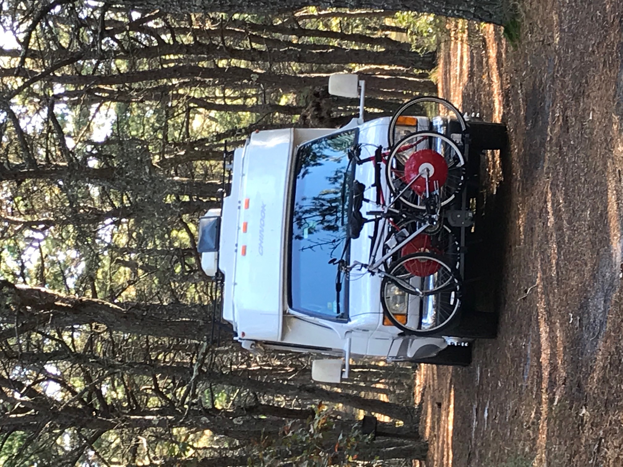

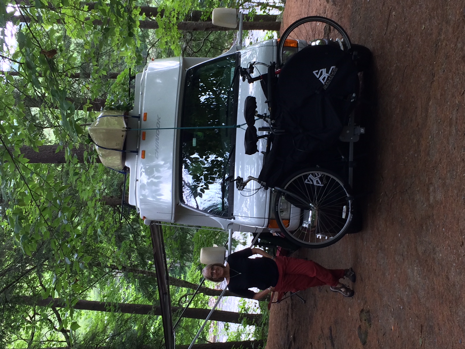

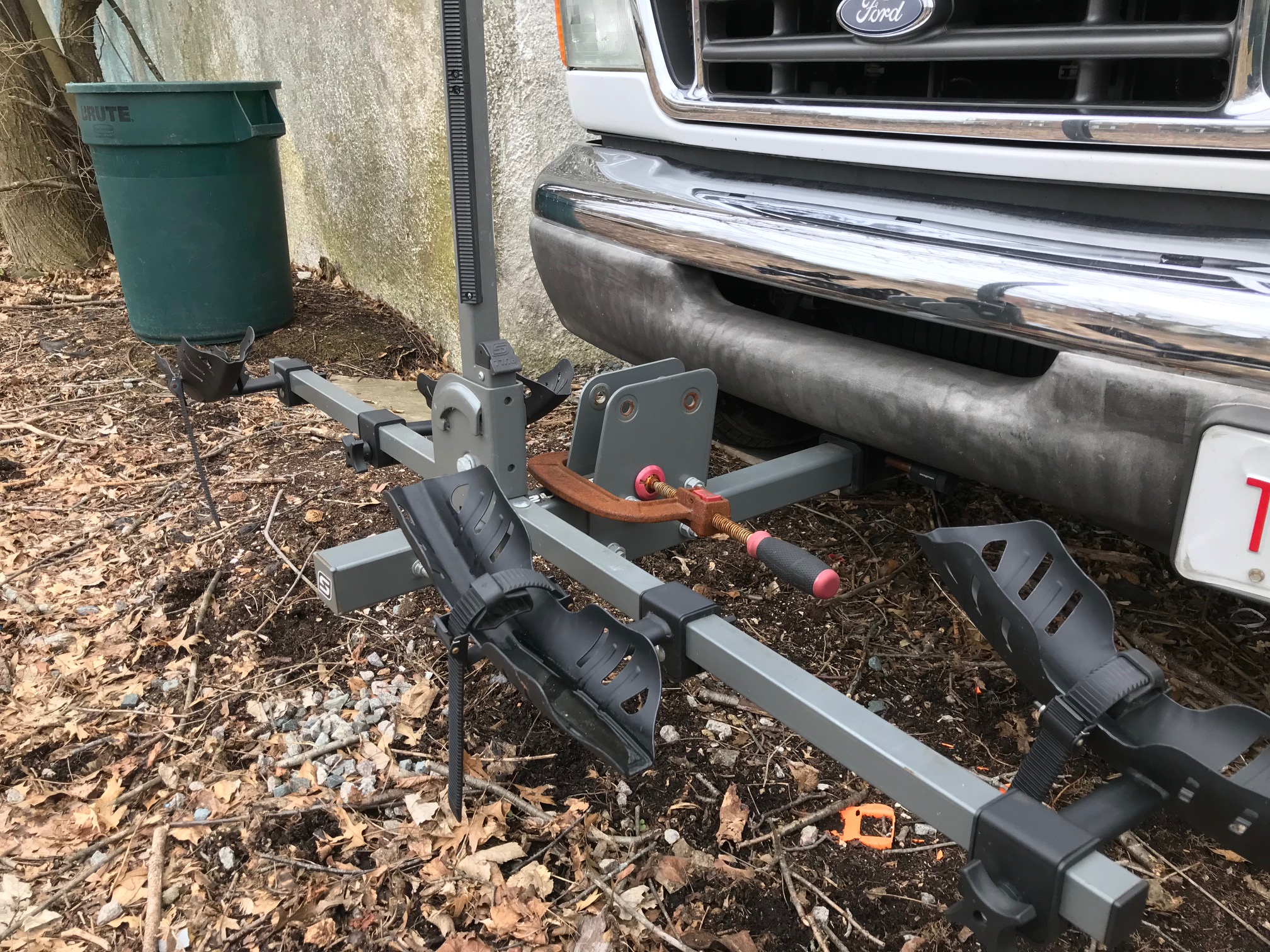

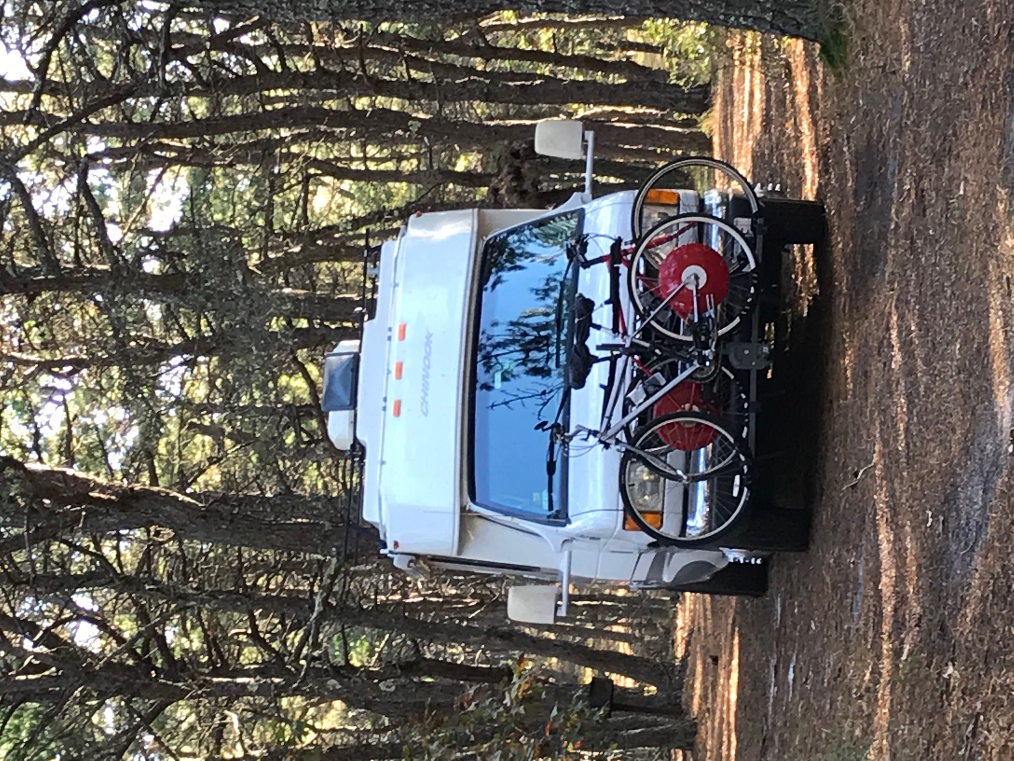

Blue--I have a 2" Curt Front Hitch that I bought from E-Trailer...plugged in my 2004 E-350 Super Duty Chassis to get the right fit. The Bike Rack itself is a Swagman Dispatch. Good for up to 45 lbs. per bike (with our Copenhagen Wheels, we are at 42 lbs./bike). I also like this particular hitch because it has a treaded locking pin that draws the rack tight to the hitch mount.
I am attaching some pics that show the bikes mounted without covers, with the Skinz Frame Covers previously mentioned, and then close-up of the empty rack itself. Couple of my own mods to note--looking at the close-up pic, you will notice that I dropped the top bar down from it's original position (indicated by the two now empty bolt holes), to rest directly on the main 2" bar that connects to the hitch. This allowed me to lower the bikes so that they would not interfere with the headlights nearly as much. To improve headlight visibility even more, I off set the mounting of the bikes by putting the real wheels (the one's that are covered and therefore have most potential to block headlights) closer to the center...as much as I can without creating too much overhang of the front wheel (which extends to just a hair beyond the wheel well...but well inside the dimensional width of the Rig itself. A second mod involves the use of the C-clamp seen in the close-up photo. This is a screw-type clamp rated at 2,500 lbs of torque that I use to further "snug" the bar that actually holds the bikes to the supporting fins of the bike rack. It works like a charm! Between that and the treaded locking pin, I have virtually NO SWAY goin down the road. Final mod was to cut the top bar to shorten it just a bit to minimize front overhang...couldn't do as much as I originally anticipated--realizing (before it was too late, thank goodness) that I needed to have the bikes extend out at least far enough from the front grill so that I could still open the hood without having to take the bikes off the rack.
Colorider--the rack as I have it set up extends 26" out from the front bumper, and has at least 12" ground clearance (I say at least because where Rig is currently parked I can't get an exact measurement).
Final note....I confess to having been a little concerned about how mounting the bikes would affect visibility at night--I'm happy to report that this has not been an issue for me. I have done a fair amount of night driving with this set-up, and it works well--though I did upgrade to the brightest bulbs I could get without going for a full retrofit. Also, overheating has not been an issue.

Good idea on moving the thread. It's become a super resource for future bike carrying reference. I'll drop Manitou a line.
Your front bike setup it sounds pretty similar to how I did my front spare. I have the Draw-Tite version of the front hitch, but it's similar to the Curt. Then I have the spare tire holder "plugged in" to the hitch receiver where you instead have a bike rack. The Draw-Tite also has that second hole so you can tighten up with a "J" pin. That is really nice (would drive me nuts if the spare waggled around).
The Skinz covers really look slick.

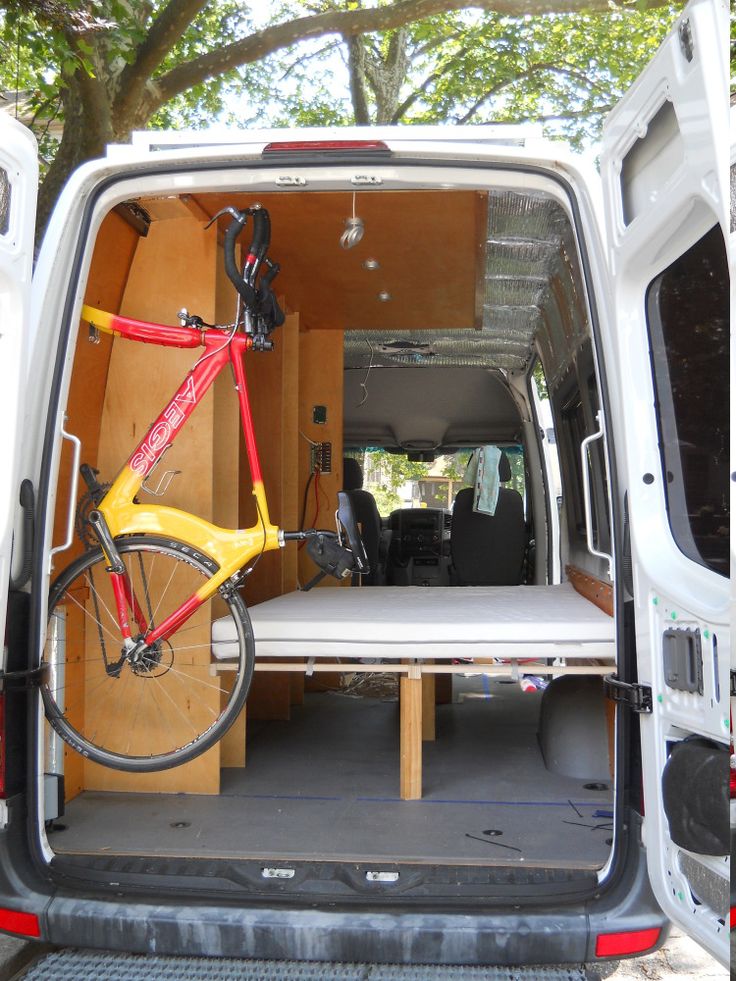

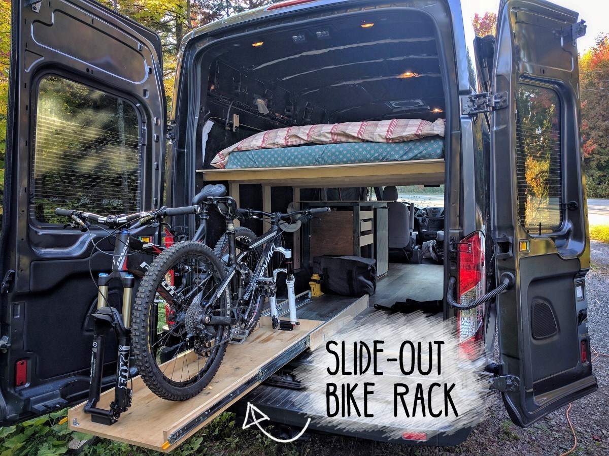

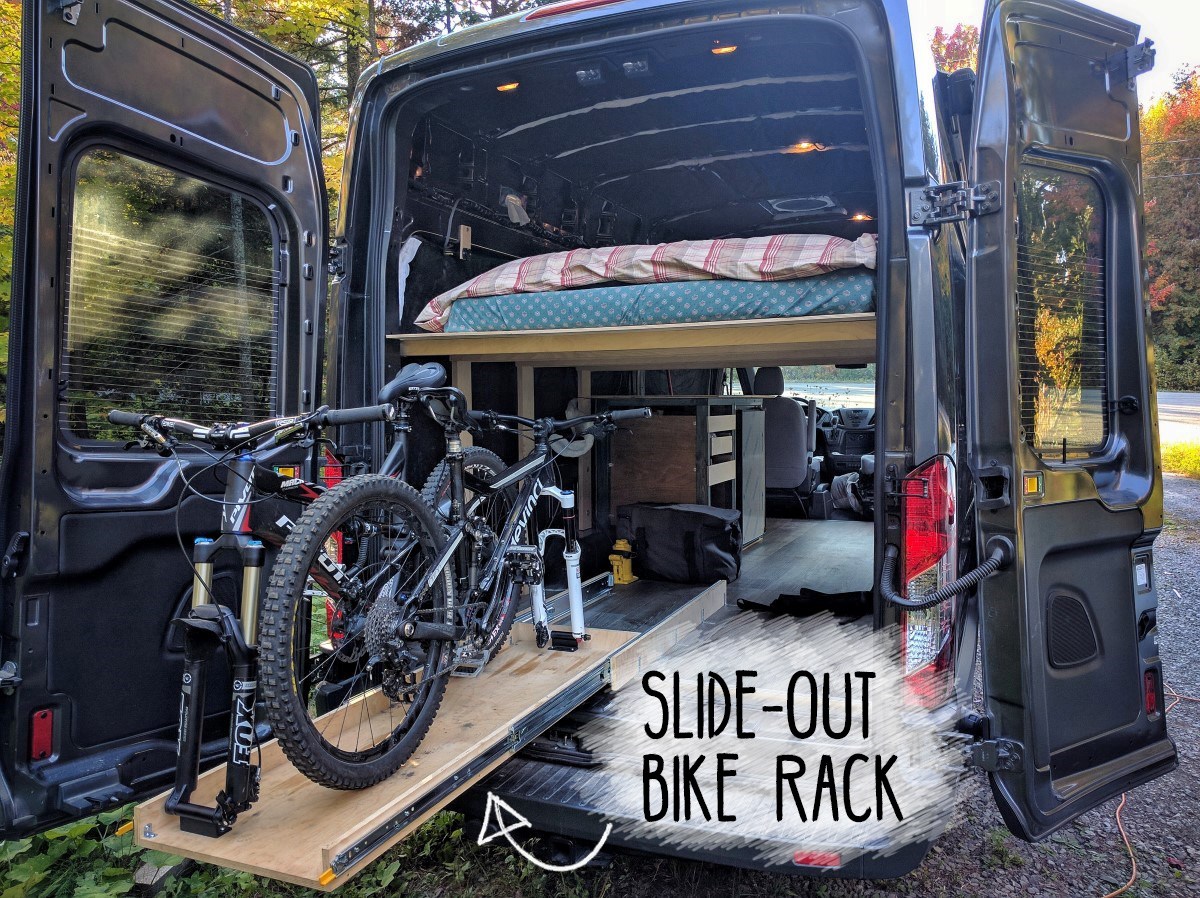

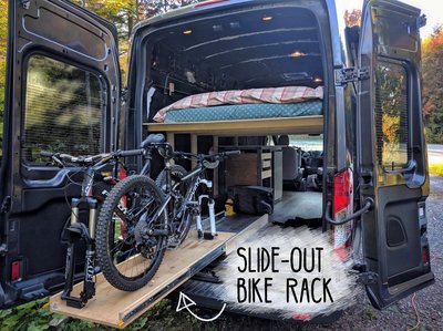

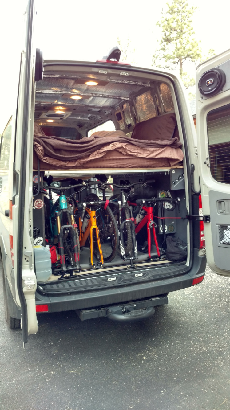

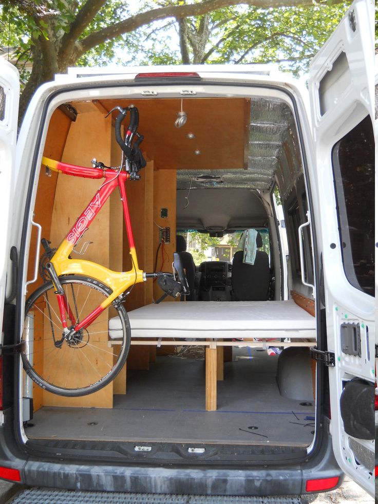

I'm one of those people whose bike is usually worth more than his car... Especially if there are a couple of us with bikes. High end mountain bikes aren't the best thing to leave hanging off of anything, so the inside storage is nice. Once we're at a campground/spot we usually lock them to a nearby tree/bumper with a cable. Not too concerned but you don't want them rolling off in the night when someone rolls through the campground...
I really just need to try to get a bike through the door and see how it works. That's my one gripe on the Chinook so far, the narrow rear entry. I've been spoiled by the barn doors on my ambulance. It really makes it easy to haul large items like a motorcycle, table saw, couches, etc.
I was about to start building my ambo with a switch to a east-west/horizontal bed layout. Unfortunately it wouldn't really have enough ceiling height to allow for a fancy "bike garage" but the Chinook would if mine was side entry. A gutted side-entry Chinook would allow for a nice bed platform for sure.
Some ideas of where I'm coming from:
