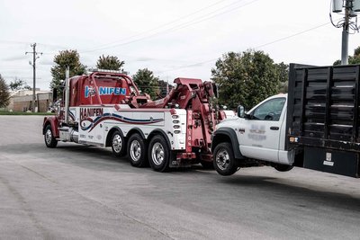

Actually, it might be called a Heavy Duty tow truck or wrecker (wrecker is sounding familiar). Oh, and they do normally tow using the drive wheels, but the rear overhang, again, was too long for the truck to get its fork-lift thing far enough, sigh.
It looked like the tow truck in this picture, towing the white garden-type truck (I just found the image using google, but mine looked very much like this one).

Good to know (well, err, sort of). I notice they are pulling the stake truck by the front wheels as well. Maybe also because of an overhang.

What BobW9 said ^^^^^ I needed my Chinook towed 30 miles at highway speed when the fuel pump went out. I knew better than to rely on some generic roadside assistance company and went with a service who specialize in recovering tractor trailers off the freeway.
They immediately understood my needs over the phone and dispatched a truck with hydraulic lift that scoops under the front tires like the photo shows. Absolutely - the driveshaft must be removed to avoid transmission damage!
I saved some time and money by doing this myself and laying the shaft inside. The four bolts attaching the driveshaft to the differential are indeed a chore to remove without an impact/air gun. I persisted with hand tools (12-point offset wrench) and fortunately the Chinook has enough room to lay its driveshaft inside. I was later admonished for soiling the fine carpet

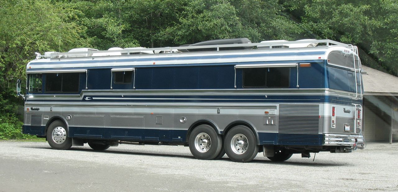

I wonder if a Blue Bird would actually be easier though (Wanderlodge was my first true motorhome crush
). They are pretty high up and don't have the (proportionately to wheelbase) long overhang. Probably a flatbed would work fine? Or maybe they use something like my ramp idea and pull it up backwards (I still wonder if that ramp idea would work?)
Speaking of Coach Net, I should probably renew with them. I had them faithfully for a number of years (never used the service though I have heard good things), but then they changed their pricing structure one year and it seemed annoying for some reason (that I can't exactly remember now). Probably by now whatever they have will seem fine since I didn't just have something better/clearer like I did then.
The good things I heard were related to them understanding what they were dealing with when you break down with something that's not a car. Also (I don't know if other services do this), they can sometimes send a technician who can diagnose and/or fix some things where you sit, so you don't have to be towed (saves them money, but saves potential towing issues on your vehicle too).
PS: Wanderlodge (Blue Bird factory motorhome conversion). Is that not the coolest Class A ever?! (But, ha, there is more complication just in the instrument panel than there is in my entire Chinook.) Still though.... swoon!
