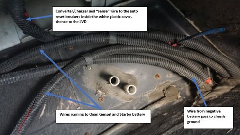

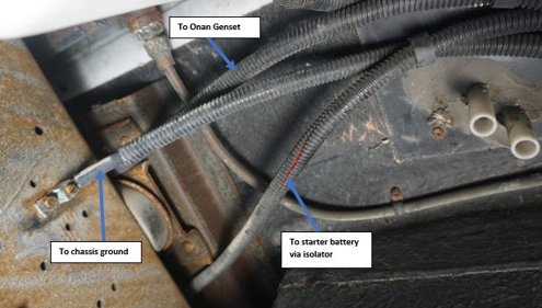

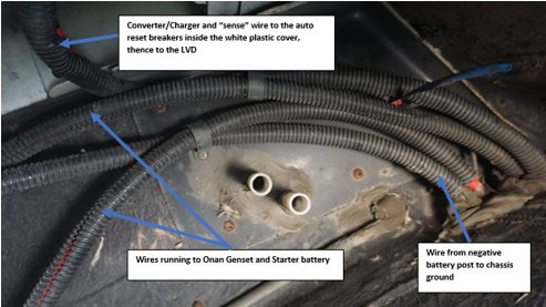

In our Chinook, the conductor run to the generator from the current battery bank runs underneath the chassis back to the generator. The run to the starter battery is also underneath the chassis. Here are a couple of photos of the wiring setup:
The first shows the wires going into the battery bank compartment as well as the 8-guage Converter/Charger wire and the 14 guage red “Sense” wire that run out of the battery bank to the auto reset breakers and then to the LVD.
This second photo again shows the three wires running under the chassis to their respective points:
I am still researching how best arrange all of the components that are to go under the couch, but without going to detail in this thread (I am saving all of the details of this for the project thread of the Forum), I will be removing the LVD (good riddance!), replacing the continuous duty solenoid in the engine compartment with a Battery Isolation Manager specific for lithium batteries, the current lead acid batteries with 2, 100 Ah lithium batteries, the Magnatek converter/charger with a PD4645LI, and replacing the 50 watt solar panel and charge controller with 400 Watts of panels and an MPPT controller, among other things. Stay tuned…
