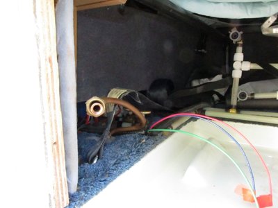

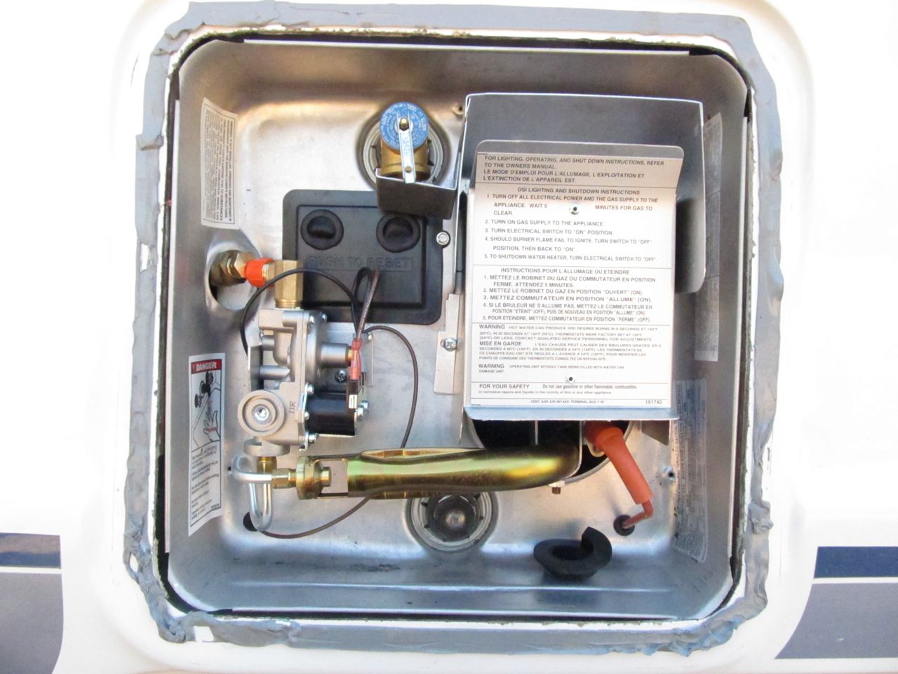

I just remembered that I took some photos when I was replacing my water heater. So these are from my '99 Concourse.
The first photo just gives you the general overview of the hole after I had removed the original water heater (don't mind the wood hanging down - those cleats Chinook puts in around the holes tend to do that because they are set in polyester "mush" -- but it's pretty simple to epoxy them back in place, and epoxy will make a solid bond).
The second one shows more detail on the original propane line (yes, they siliconed it to the carpet where it comes up through the floor
The third one is where I had just set the new water heater in place to check the fit. You can see the original Chinook propane flare is coming through the hole in the pan (sans grommet, as this is just a dry run) and kind of sitting on the orange protective cap that comes on the water heater (that you remove when you put the flare nut on).
