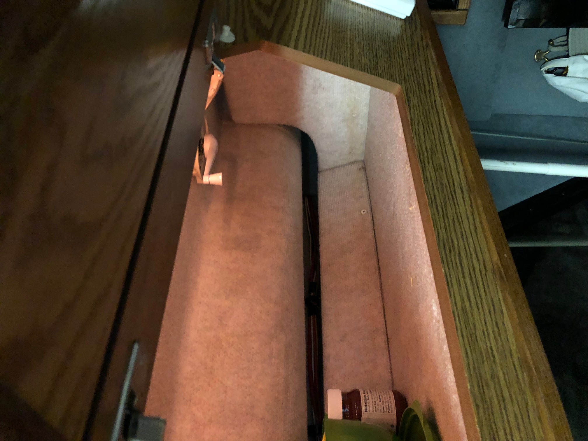

Drivers side overhead cabinet must have lost a screw someday today while traveling. The cabinets are full but I didn’t think it was overloaded but any means. I haven’t seen any broken screws or empty holes where I would expect rot see one. How are these cabinets attached?

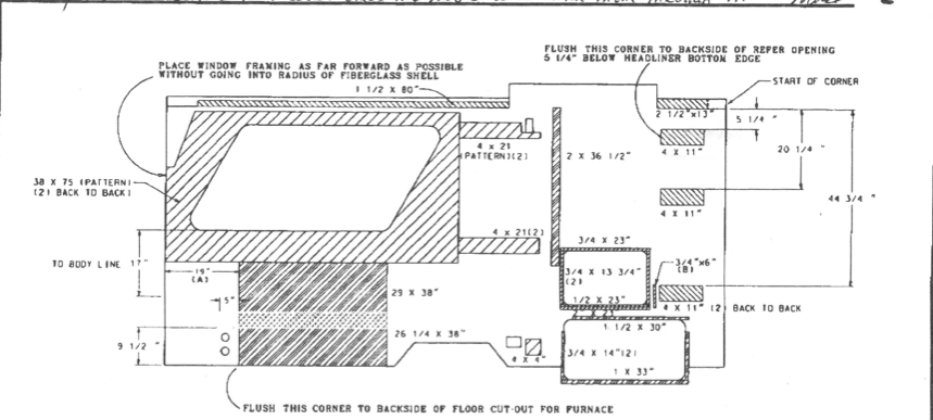

Okay, back with photos. So first of all, here is a wall drawing. This is the passenger side wall, but you get the idea. The diagonal lines around the window represent two 1/2" thick pieces of plywood back-to-back, for 1" total. In this case the upper wall edge where yours has come adrift would be on the left (but opposite since it's the driver's side). You can see how the end of the cabinet fasteners could potentially miss the end of the plywood (if that's what indeed happened, of course we don't know yet).
I had to reduce this, so you'll likely have to click to make it out.

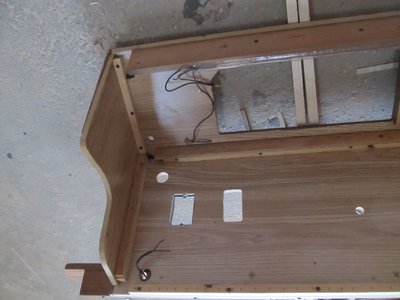

And here is a photo of one of my removed upper cabinets. In fact this is the driver's side cabinet, at the forward end, right where yours has come adrift. In the lower left of the photo, you can see a round hole with a wire coming out of it. That's the corner/edge where it looks like yours has come off. You can see a little "cleat" along the lower (in photo) edge: That's the lower cleat that runs the length and has screws through it going into the wall - it holds the back of the cabinet to the wall. At the upper edge of the photo, you can see a wider cleat (board) that also runs the length. That's where the overhead screws go up. That one's wider, IIRC, because it supports the hinges for the doors (I may be mis-remembering it exactly - anyway that doesn't matter at the moment).
If you go poking in to see what's what, know that you can remove the white carpeted "trim" pieces, and also the floor liner of the cabinets. As I remember it you remove the end ones first, then the skinny strip on the outside wall (under the roof "swoop"), then the oak septum divider in the middle door area, then the "floor."

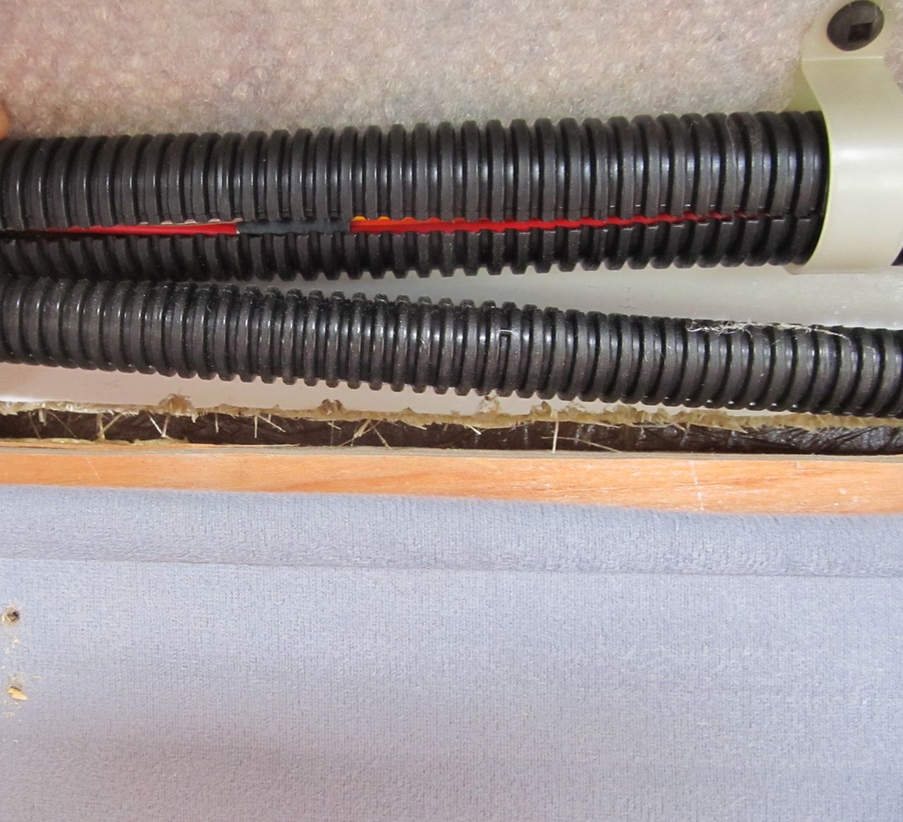

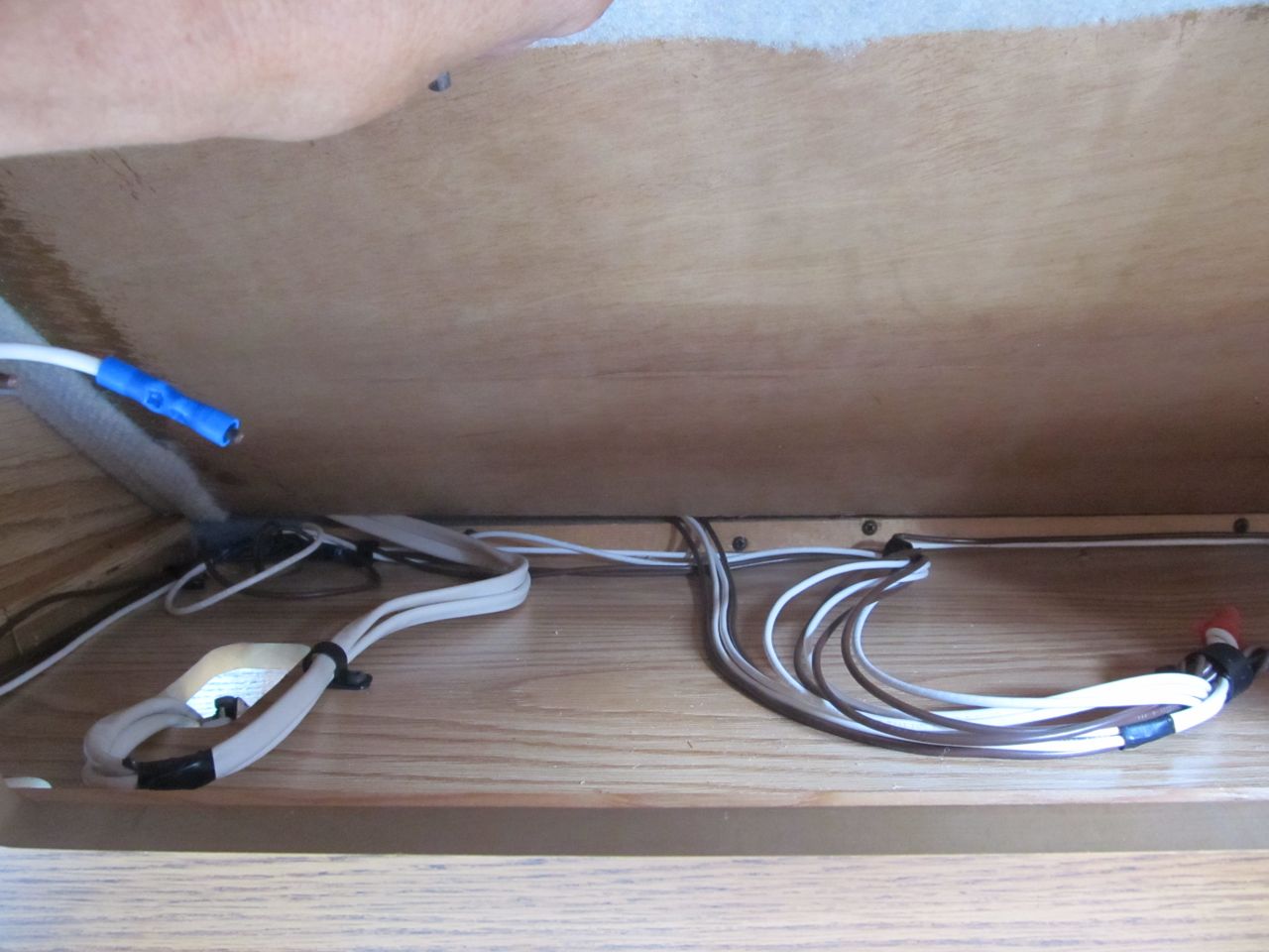

A couple more details:
In this first photo, the view shows the carpeted, false floor of the cabinet lifted up to expose what's underneath (wiring, outlet backs, etc.). This happens to be over the sink, but same idea. You can see the cleat along the outside wall with the square-drive screws going into the wall.
This is just a detail of the upper wall (passenger side I think, but they are essentially the same). This shows the wiring, which is behind the little short false wall at the back of the cabinets (under the roof swoop); then the very top edge of the window surround plywood, which is what the lower edge of the upper cabinet is attached to. The slight indent you see near the upper edge of the fabric wall is from the upper edge of the cleat (cabinet is out in this photo).

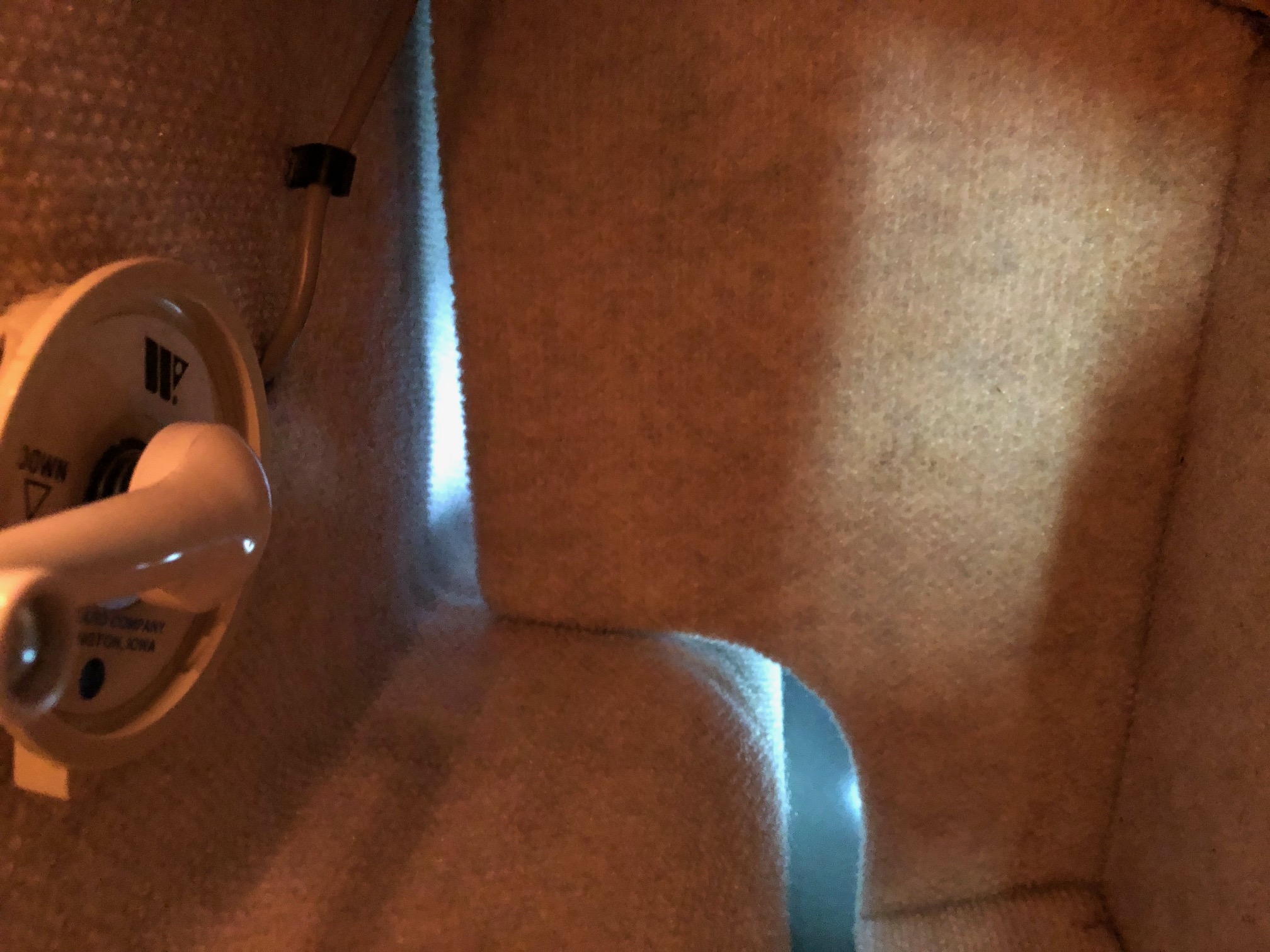

I followed the instructions offered by BG and after removing some trim pieces I found no wood rot nor the ability to remove needed pieces for a repair. I don’t have many tools available so I plan to find a cabinet maker, RV dealer or find the Blue-Go repair shop as we continue westbound. In the meantime, spring loaded shower curtain rods to the rescue. I really need only one but I’m using two for peace of mind.
