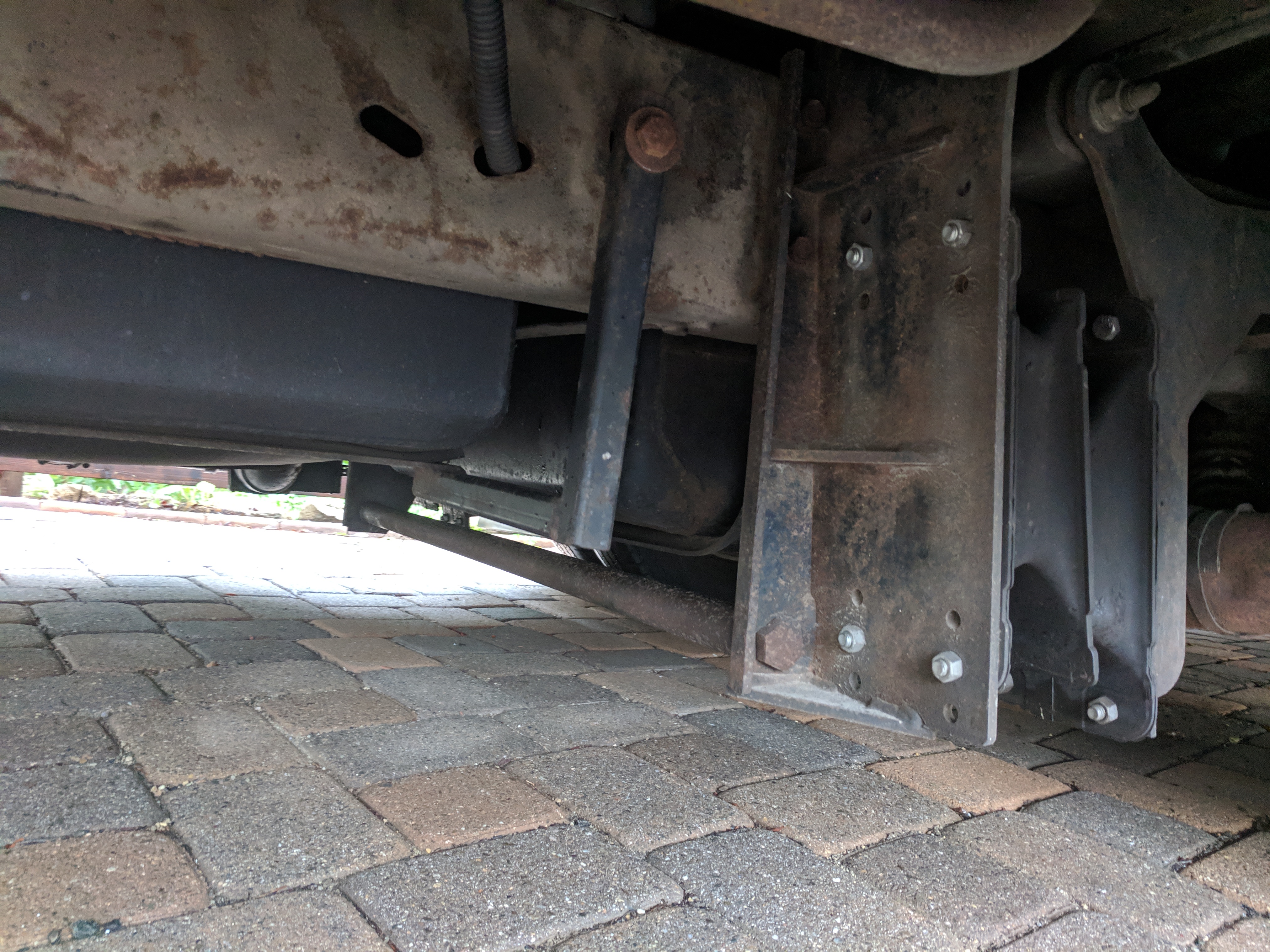

Which part of the MorRyde help with the sway? Besides the rubber "springs," there is a metal bracket that connect the leaf spring to the rubber spring, is that it? I can't see how it going to help with the sway.caconcourse wrote: ↑January 16th, 2019, 2:50 pm You may not be aware of it but the MorRyde system includes an anti-sway bar between the spring holders, so it address both up and down and lateral issues. It is just a straight rod, but I guess the rubber provides the left and right damping action, as well as up and down.

Here is a picture of the anti-sway bar between the rubber springs.chin_k wrote: ↑January 17th, 2019, 8:05 amWhich part of the MorRyde help with the sway? Besides the rubber "springs," there is a metal bracket that connect the leaf spring to the rubber spring, is that it? I can't see how it going to help with the sway.caconcourse wrote: ↑January 16th, 2019, 2:50 pm You may not be aware of it but the MorRyde system includes an anti-sway bar between the spring holders, so it address both up and down and lateral issues. It is just a straight rod, but I guess the rubber provides the left and right damping action, as well as up and down.
Re: New leaf springs question
I always assume the bar is for structural support of the rectangular brackets. Since there is no transfer of torsion or movement from one side of the suspension to the other side when the vehicle rolls, I don't think there is any anti-sway effect, correct?
I had never seen that bar (I don't have Mor-Ryde). But.... I agree that I'm not sure it would provide any real anti-sway/anti-roll action. The actual anti-sway bar I have is much thicker (even though I went down to a thinner one) It is trying to connect one side of the vehicle to the other to transfer weight (I'm sure there are better ways to explain it). Those metal plates on each side of the rubber don't look very "structural"?
