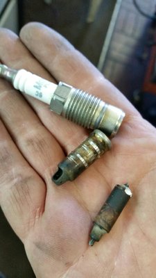

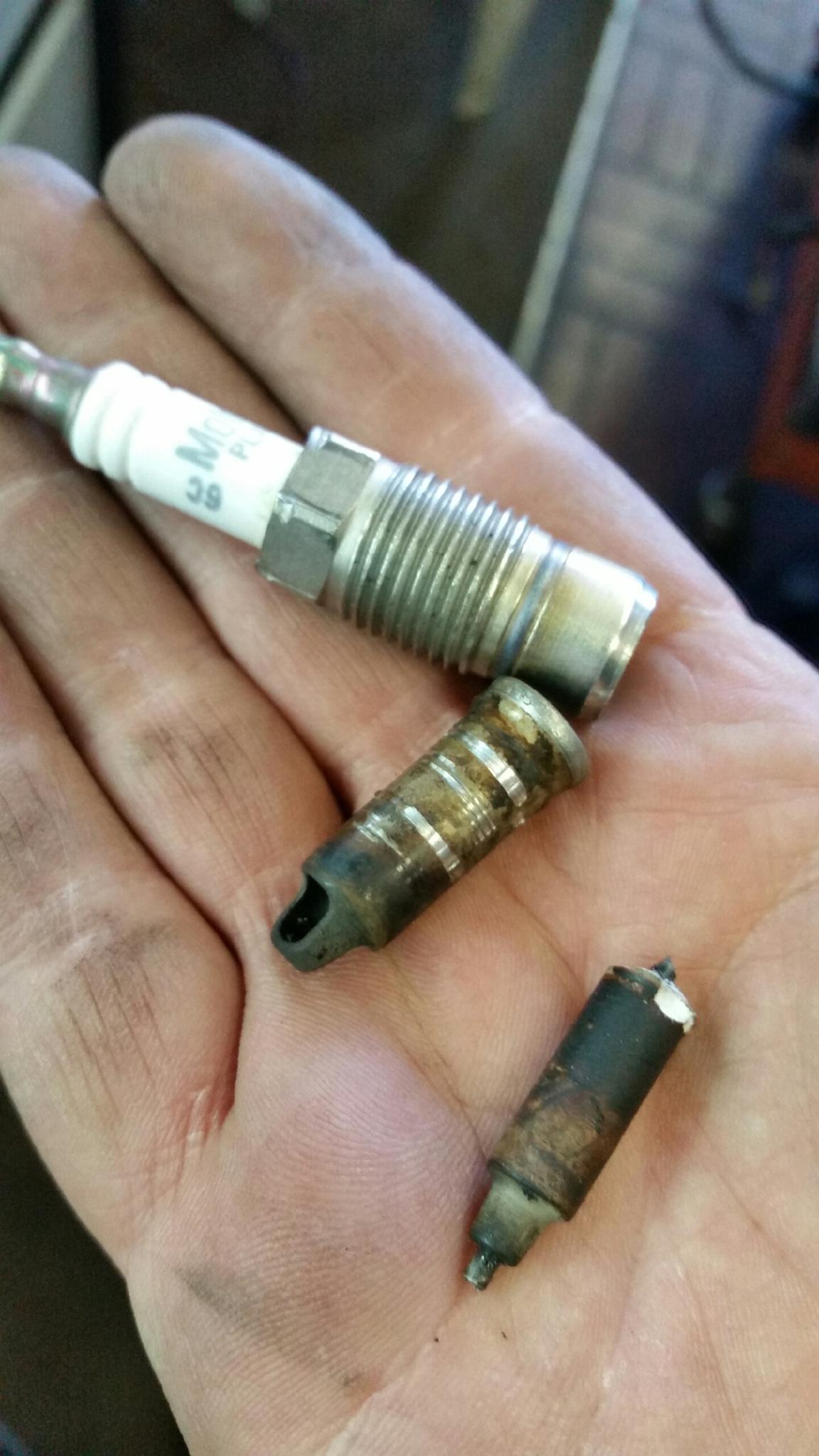

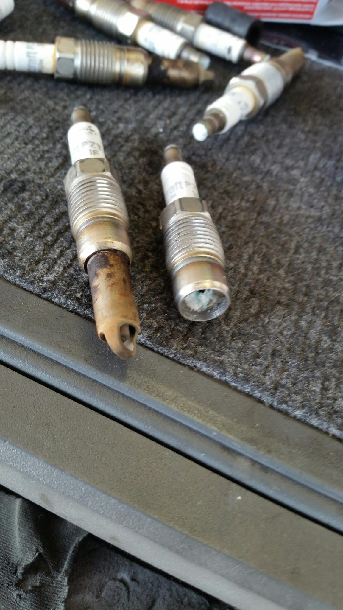

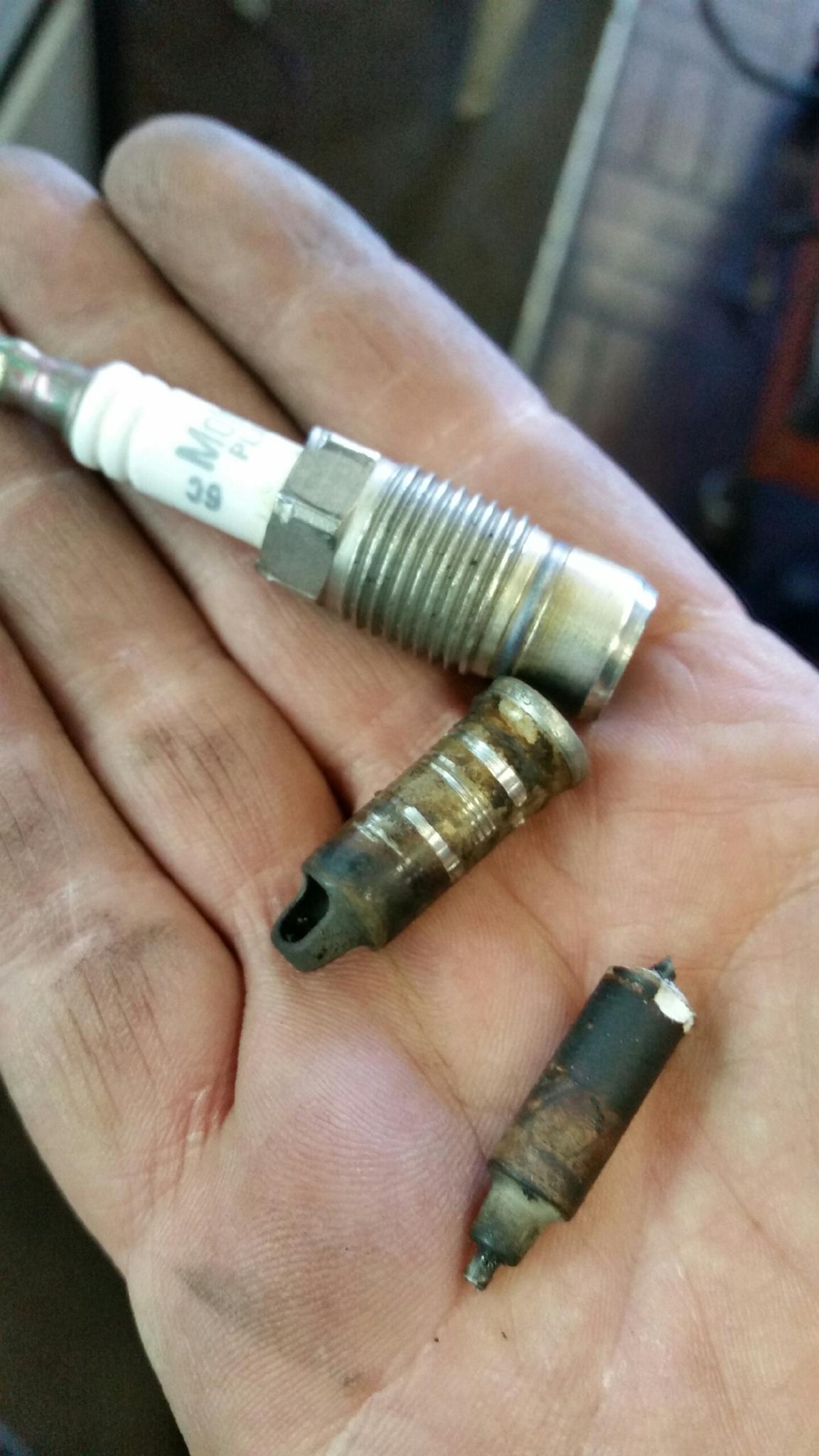

This is more Ford than Chinook but I just wanted to take up a bunch of space and mention a couple things. I am familiar with the "stuck inside" scenario. There's an extension on the plugs called a ground electrode shell. It gets carbon on it (normal) which causes it to get stuck in the head (not normal) when removing the plugs. There are kits available to get the piece out of the cylinder if it breaks off and falls in, but it can be tough to do. This picture is of the plugs I pulled from a V8 truck a few days ago (I don't know the model year). This happens to many iterations of the modular platform, from vans to trucks to mustangs.
I personally haven't seen one where a plug was spat out, but a Heli-Coil would be my first choice for repairing a stripped thread, mostly because I'm familiar with installing them and I've never once had one go bad. But maybe the one you (Blue) referred to is the standard for these motors?
Apart from an odd design, another booger in Ford's defense case is that the suggested change interval for plugs is 100k miles, which is beyond the factory warranty. So they essentially considered the plugs a lifetime component, which is insane. Pretty sleazy. Some iridium plugs can last for ages, but that doesn't mean they should. Just breaking loose an older set of plugs can help by sort of "resetting the clock" on the potential for the two materials to marry, but really it's carbon that locks them in. Doing yours at 49k was certainly a wise decision. Risky, but wise.

One or the other symptom can apply to basically all of the Ford modular engines, V10 or V8 or whatever. As a percentage, it's not too terribly common. We just hear about the failures and not the successes.
If the plugs are torqued and they're OEM parts, that's a good start. But they still can loosen and dislodge themselves. Good idea to check them periodically, whichever motor.
The scenario I encountered above is totally different and irrespective of torque. It's from carbon buildup.
But yes, the 460 doesn't have this problem. Regular old $2 plugs are just fine for, I dunno, 30k miles at least. Iron heads, pushrods, totally different animal. But it's not all rainbows and puppies for us either. 460s have exhaust manifold issues. Check the passenger side, all the way to the rear. Is the screw missing its head?
