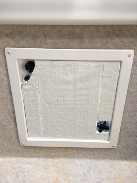

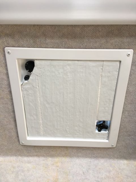

The trip also confirmed a cheap and simple fix for the notorious Fan-Tastic vent lid wind noise. I cut a panel from 1” styrofoam to fit tightly from the inside to not only insulate the opening but also damp high-frequency pressure waves driven by turbulence over the roof line. That’s my theory anyway to justify the good result.

How did you fit that Styrofoam to the Fantastic Fan? Mine has all these controls that protrude down from the screen.

Glad you asked, Paul.
The attached pictures (downsized so hopefully both post) show the setup. First, the styrofoam slab was cut carefully for an interference fit so it wedges itself in place. Next it was wrapped in white duct tape for reinforcement and to prevent shedding of styrofoam crumbs. Finally, the top side under the fan has aluminized tape to reflect heat.
I cut notches to clear the controls. These also allow room for a finger to remove the insulation when required. Cheap, simple, light.

Actually that picture is Ted's, but I did the same exact thing for my skylight, except Ted's is fancier with the duct tape overlay . Mine's just shiny one side, white other side, with a couple adhesive saddle ties and a piece of wire for a handle (Airstream-level elegance ).
