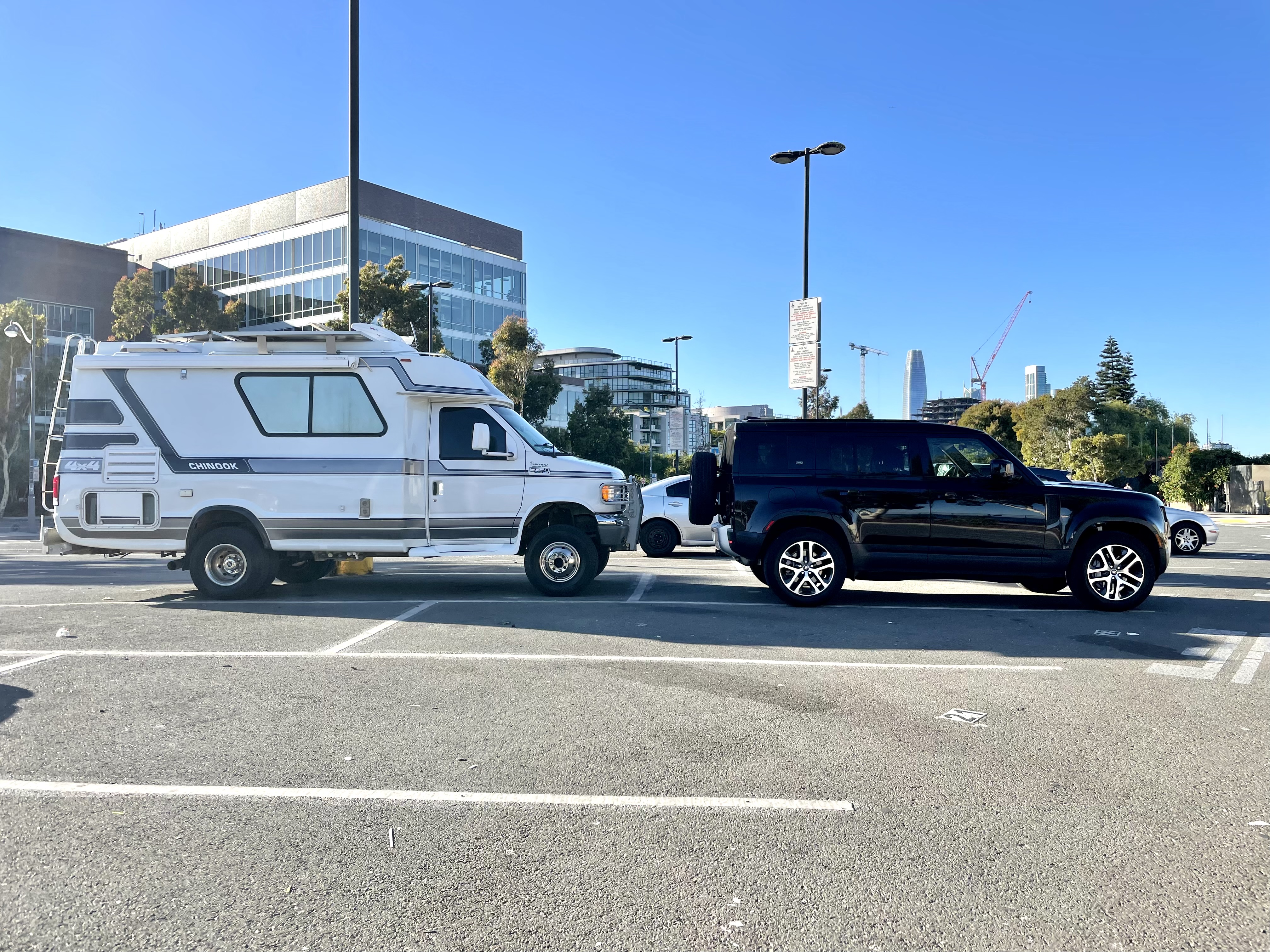

I just did Weldtec rear leaf spring and local new front leafs and new suspension and brakes all around. Makes my 2000 chinook feel like new. I take speedbumps at 20mph and rally around san francisco like a maniac. It really is the sportscar of motorhomes now.
