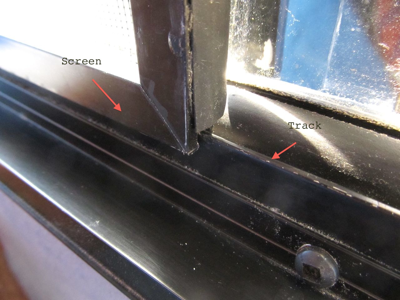

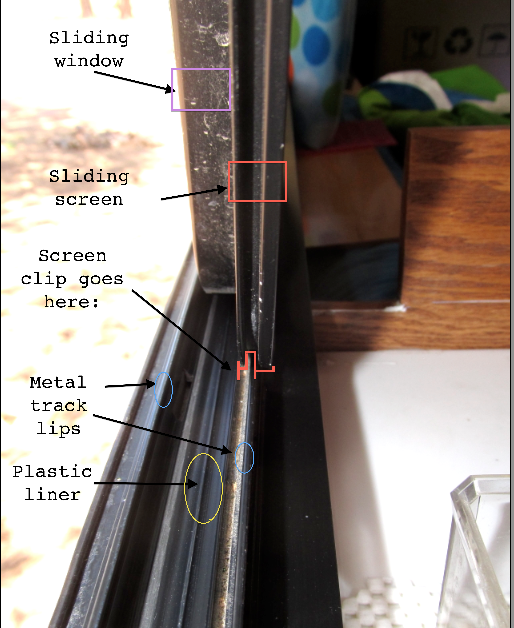

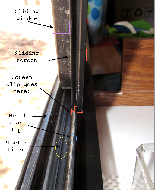

The windows this topic applies to are the single pane Concourse windows used (just) prior to when they went to double pane, which I think was around 2000. I'm pretty sure I have heard of this style on at least 1997, 1998, and 1999 Concourses; not sure if they would apply to other years or to Premier windows.

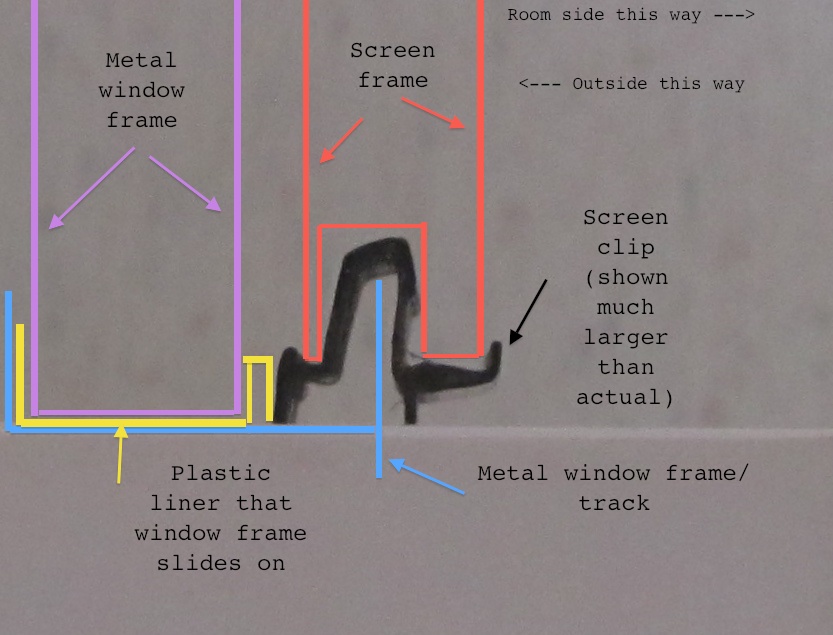

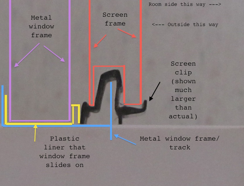

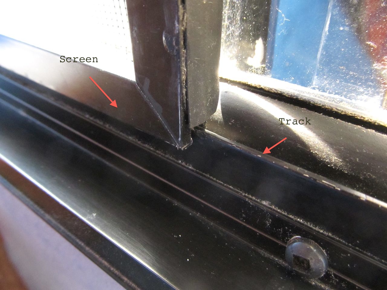

On this window style, the screen does not ride in its own track, like is often the case. Instead, it rides on the inner rim of the main track (that the opening window pane rides in). Nothing holds it in place except for small plastic clips. No clips, no screen stay in - it just falls out and you have a screen/frame in your hand (or on the floor...)
When I got my rig, the sink side window had a full complement of clips (six, although seven might be even better). So I could see how it should be. The stove side screen was (sort of) held in by mounds of tape. I found one precious clip on the floor behind the club chair. I then carried this clip around for two years, stopping in to every new/old/dusty RV place I could find. No-one knew a thing about it. I also scoured the web (Google, Pellandent, Interstate Metals, and on and on). No dice. I also called Aubrey's RV, and they seemed to know the clips I was referring to, but said they had never been able to get them, even though they had tried.

The first thing I noticed is that all the clips weren't the same. That was when I figured out that the bottom clips are different, and serve to "hold up" the screen (otherwise it tends to sink down) as well as somewhat holding it in place. Then the top clips mostly just hold it in place. So THEN I went hunting again, and found that I think the bottom clips ARE available (I am going to order some and will report back, as we've all seen how this sort of thing goes .... no counting chickens yet). I'll report back on this. But even if these are the correct ones and available, they won't work on the top (I tried) so something else is still needed in place of the top clips.
I did find that straws only around the full window tend to hold the screen frame up almost as well as the real bottom clips and also work decently well in place of the top clips. So to summarize, a full set of top and bottom original clips is the best. Original bottom clips combined with straws also works very well (bottom clips won't work on the top and the top clips are seemingly impossible to buy). But full straws (top and bottom) also works pretty well, considering -- even with no factory clips, albeit I don't think they'd stand up to repeated sliding of the screen open and closed.

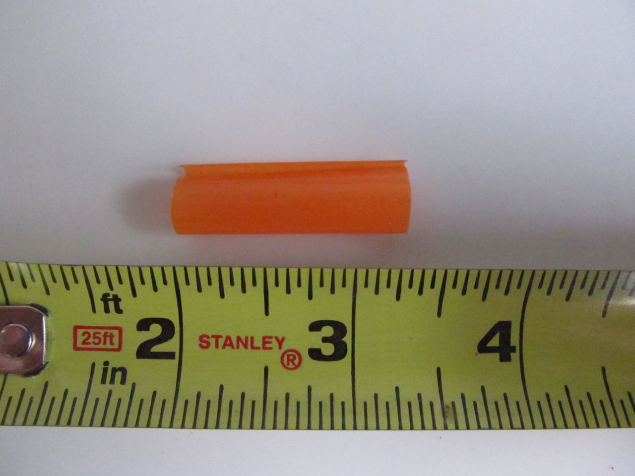

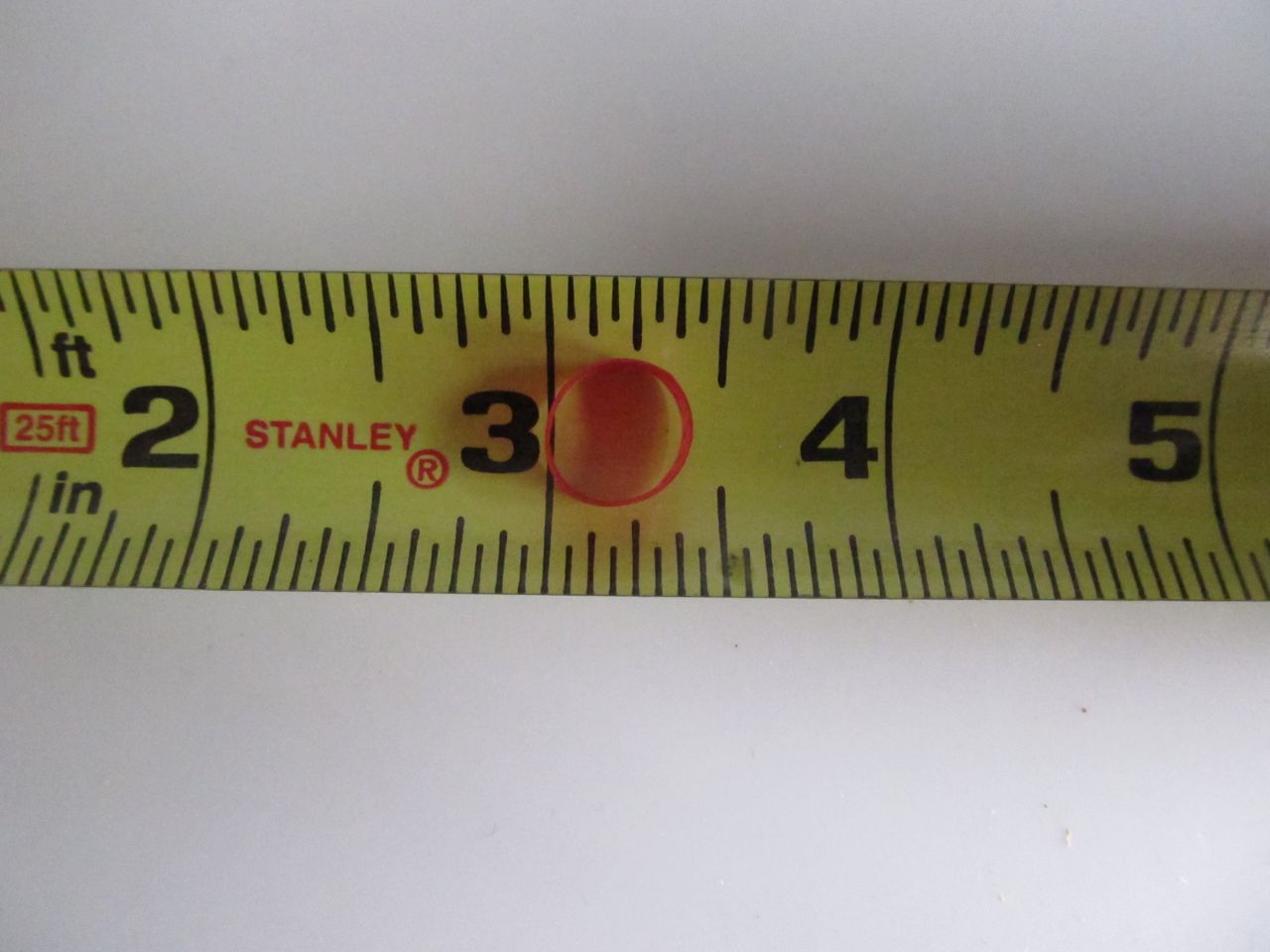

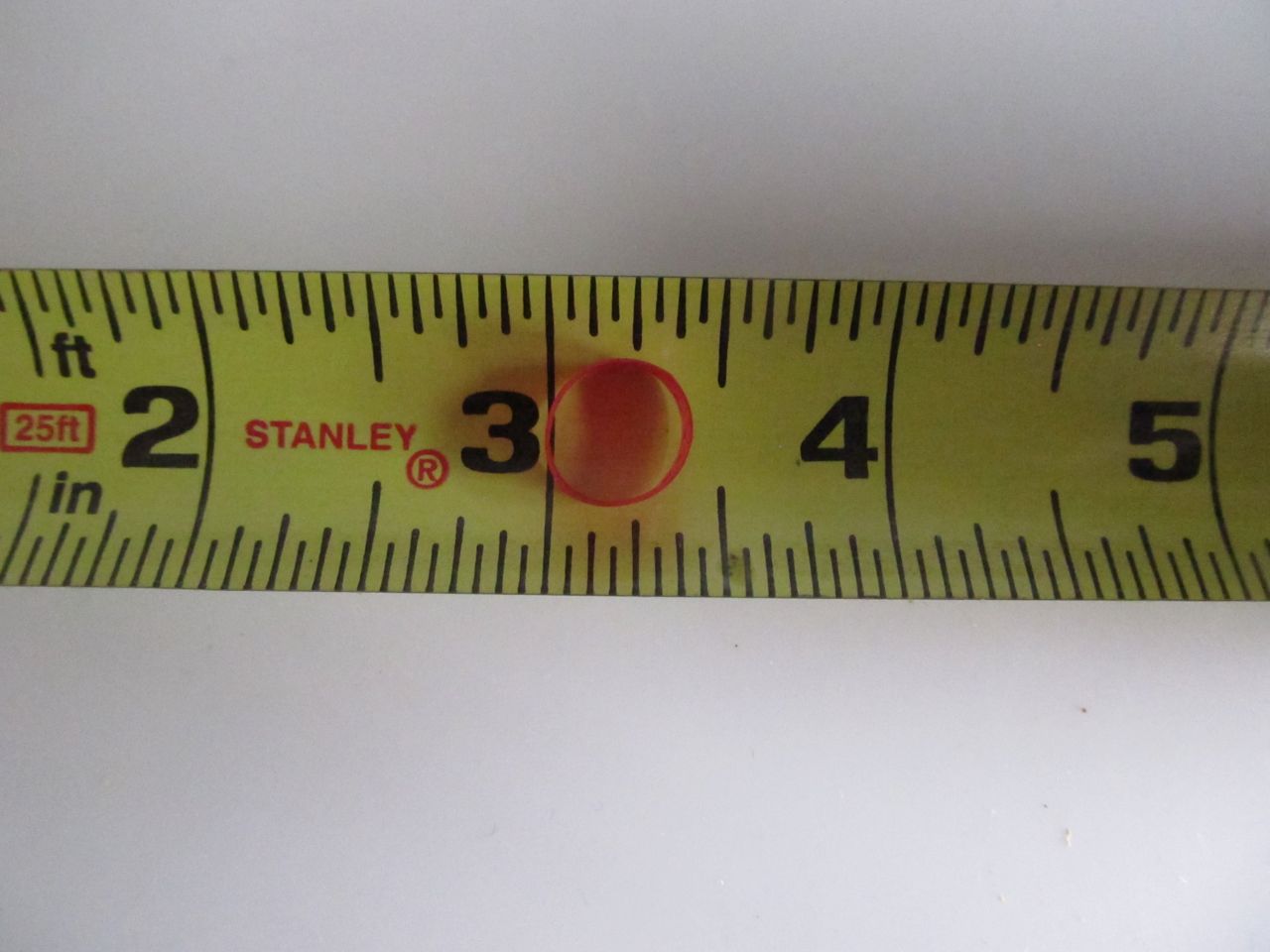

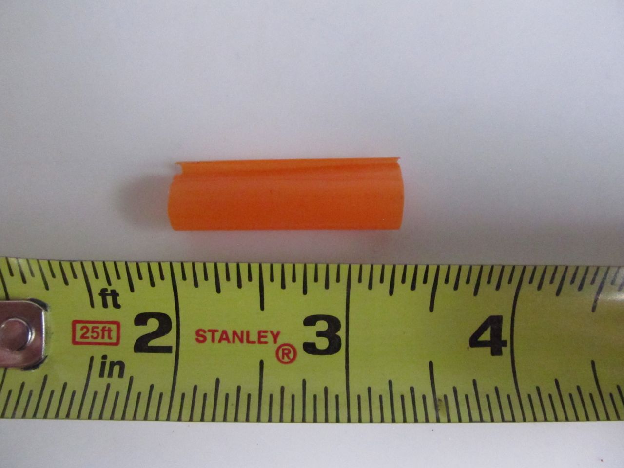

So, I started with what you might call "smoothie straws." What makes them different from typical ones is they are a bit larger in diameter. These were about 7/16" (about 11mm) vs. a typical straw which I measured at just over 1/4" in diameter (about 6.5mm). Here is a photo that shows what I used (slightly thicker construction might be nice, but I'm camped in the boonies so only had what I had).
I cut sections that were just a bit over an inch long (original clips were an inch, so just chose it somewhat arbitrarily, but easy enough to experiment on length). Then I used scissors to cut them lengthwise into a sort of long U shape (this one is already cut, which is why it looks smaller in diameter - it folds in on itself a bit).
