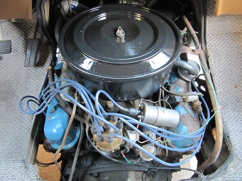

My Mopar 360 is stock and I'm thinking of souping it up with ceramic coated headers and dual exhaust. Probably will also convert to 4 barrel as well, which means a different intake manifold. If I have to rebuild the engine in the future, I'll install a hotter camshaft at that time.
Here's how it looks currently: And yes, that's a Berber carpet!
