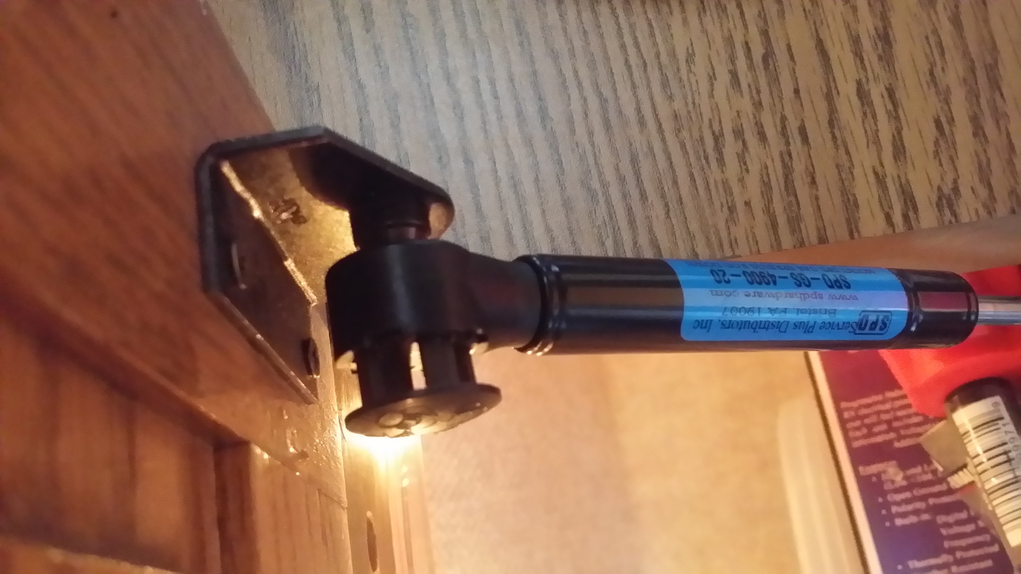

Post by Skillet »
I can see to unlock them you pull up on each end cap as shown in this picture. But from there I don't know if you force it off or have to do something else. I'm assuming it's on a ball joint.
Re: Removing gas cabinet struts
I can't tell if yours are just the same as mine, but on mine there is a little metal band on one side of the "ball" part (that fits over the pin) and you put a flat-bladed screwdriver into that band and pry slightly. Not in an "I'm going to bend this" way, but rather in a "this is meant to be lifted to release it" way.
Even if you don't have the band, it's probably something similar. Some sort of "lift and release." The pin it sits on has a ball shaped thing on the end that the strut "grips."
At any rate, once you get it released (however they want that to happen), it just pulls off the pin. You do kind of have to angle/pull/wiggle it a bit. I always find myself saying "This isn't going to come off, ugh I hate these things, it's never gonna..... " and then suddenly it comes off easy peasy. :roll:

Yep... what Blue-Go said. Mine are like yours. Replaced all of those worn out struts this summer. "Easy peasy". :P

Post by Skillet »
I'm going to order a bunch of new struts tonight so I'll attempt the removal tomorrow in the daylight. So looking at my picture of the end "popped up" do you think that takes the place of the band? I don't see anything else and both ends have this item. By the way, the battery/storage compartment on the driver side (Concourse at least), has anyone added struts? I have to use a bungee to hold the lid up when I pull the battery tray out.
Skillet wrote:I'm going to order a bunch of new struts tonight so I'll attempt the removal tomorrow in the daylight. So looking at my picture of the end "popped up" do you think that takes the place of the band? I don't see anything else and both ends have this item.
That'd be my theory. Maybe once you get the new ones you can see something from the way they are? (My new ones have the bands, but I don't suppose they are all the same.) The main thing is that they are "gripping" over a small metal ball (that's on the end of the part that stays on the cabinet) so somehow you have to get the strut to release the ball.
